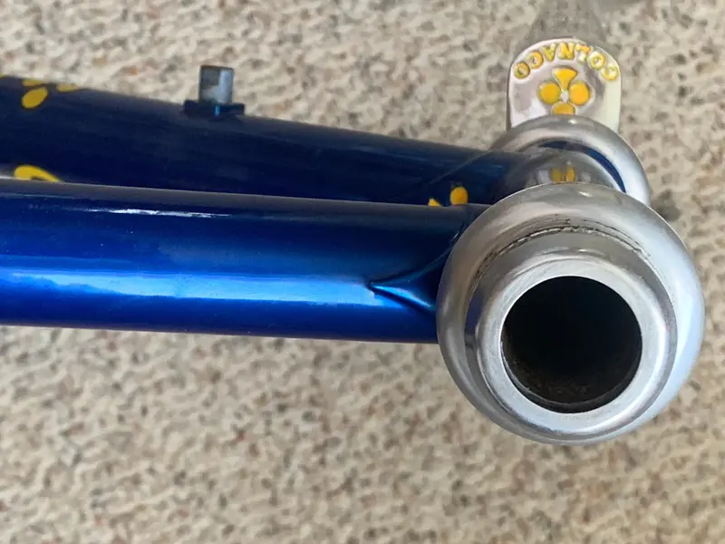

Those seat stay caps are too sharp and the Colnago club on the BB shell looks a little weird. On that type/era of BB shell cutout the bottom of the leg on the club should be flat?

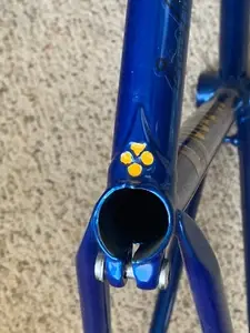

Here is what he finally provided for imagery:
So much excess paint and a horrible highlight job; but it was "professionally" painted (by Helen Keller!).
Nice non-view of the lower lug which was of prime interest to me! I made that very clear to him; but better photos were not forthcoming. I think je was either irrotated at being proven wrong or that the bluff was called. All he could do was come up irrational replies statingyself as the amateur (even though he claimed going to Classic Rendezvous and other sites. I did not need to search anything.

Anyways, even with what I believe to be an authentic Colnago fork, the frame misses on many points judging from my 20 minutes of experience: 1) "spearpoint" stay caps never appeared on any model from 1968 to present; even the "Sport" had fluted caps. 2) Never seen a "clubs" cut-out on the seat lug except the earliest (pre c. '72) frames. 3) Never seen that BB drain before.
I'll discount any other issues (wrong decals, guide #, etc.) since those 3 features are alien to any Colnago frame I have; have previously owned, and/or seen made from '79-'83 (assume approx. year range of that frame).

If it's real Colnago it could be Export or Sport, but it's hard to tell if those chainstays are even crimped.
the Sport had slotted BB drain (at least some did), the Export is a Super geometry with blank stay caps and a "non-specified" Columbus tubeset (AELLE?). Neither had those "spearpoint" stay caps.
