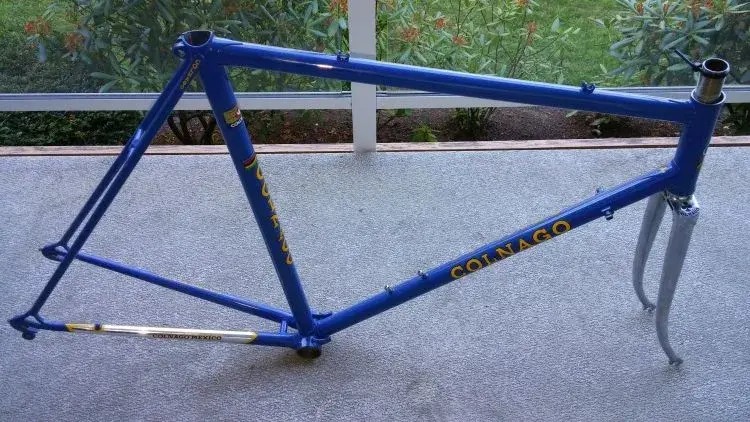

I picked up this Colnago Mexico frame about 18 months ago. I think it's a late 70s frame. These Mexico's are made from Columbus KL tubing and it weighs 1780g frame / 717g fork.

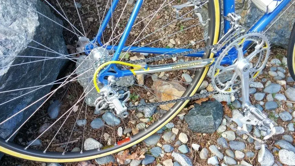

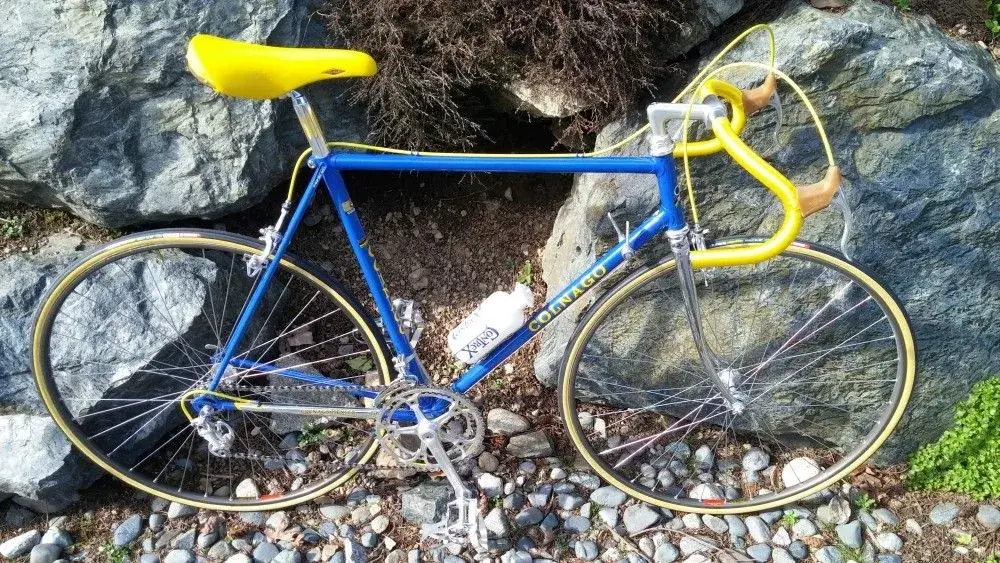

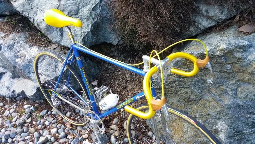

Here's the final build after just recently sourcing a yellow Rolls saddle.
Here's the build sheet.
Frame/Fork: 56cm Colnago Mexico '79ish - Columbus KL tubing
Headset: Campagnolo Super Record
Stem: Cinelli 1A
Handlebar: Cinelli Criterium
Bar Tape: Benotto Cello
Brake Levers: Campagnolo Nuovo Record
Brake Calipers: Campagnolo Nuovo Record
Shifters: Campagnolo Record
Front Derailleur: Campagnolo Nuovo Record 4-hole '78
Rear Derailleur: Campagnolo Nuovo Record
Derailleur Cables: Campagnolo
Cassette:
Cranks: Campagnolo Super Record
Chainrings: Campagnolo Super Record 52 / 42
Bottom Bracket: Campagnolo Record
Pedals: Campagnolo Record (stamped 1037)
Toeclips/Straps : Campagnolo
Rims: Mavic GP4 36 hole
Hubs: Campagnolo Record
Tubes: Vittoria Rally
Saddle: Selle San Marco Rolls
Seatpost: Campagnolo Super Record 27.2
Seatpost Binder: Campagnolo
Bottle: Contrex
I was maybe thinking of doing yellow infill on the part of the rear mech with the raised "Campagnolo" lettering. I've seen a few done like that.
