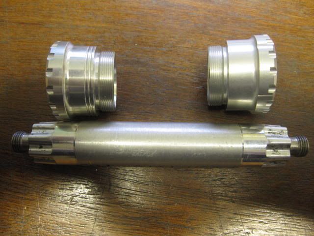

I understand that the Magic Cranks have a specific bottom bracket, and looking at it, it looks like it has external bearings.
I wondered if a special tool was needed to remove the cranks and bottom bracket, or whether a regular external BB remover will do the job? Also I've read that the cranks have self-extracting bolts so no special tool would be required, is that right?

There was a special splined CODA tool for the bottom bracket cups, but I'm told a Shimano external cup tool will work.
Yup, Barney, just need a 6mm Allen key (anti-clockwise) to wind the cranks off.
Unlike Sugino/Shimano/Syncros etc. the bolt stays with the axle, but isn't captive. A left-hand thread pushes the crank off the axle spline.
The splines on the cups are covered by the hoods on the cranks. Neat and tidy, and protected from mud, brilliant:

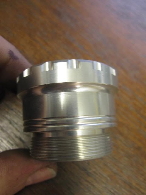

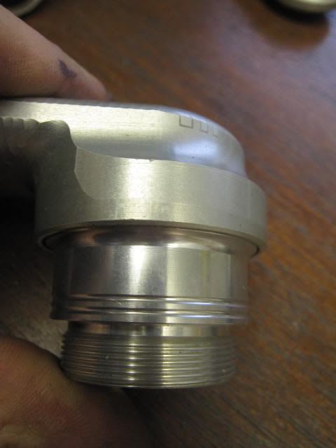

A few of things to watch:
1: The bearings are so outboard that the drive side cup needs five small cut outs to clear the inner chainring bolts. As you pull the RH crank off, these needs to be lined up with the inner chainring bolts, otherwise they foul.
2: The new Shimano fit splined BB tool is close, but a bit loose. It could slip or marr the Coda splines. I've got an original Magic Motorcycle tool you can borrow (On pain of death :shock: ) PM if you want to borrow it. I've got a manual somewhere, too...

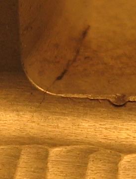

3: I'm not sure of Cannondale timelines, but check the serial numbers...there was a recall of these cranks, 1997/1998 (to add to the recall of 2000/2001 Ravens):
Cannondale has determined that some of the CODA 900 Compact Mountain (94/56mm BCD (bolt circle diameter), CODA 900 Standard Mountain (110/74mm BCD), and CODA 900 Standard Road (130mm BCD) left and right crankarms may be defective.
Some of these may split or separate at the adhesive bond line in the center of the crankarm. Unlike a fatigue crack in an all metal product, this "crack" will not grow slowly, but may fail quickly. This design is dependent upon both sides being properly bonded together, and a failure of this bond line could lead to crank failure with the risk of accident, injury, or death.
These crankarms and/or bicycles (1997 Super V3000, SuperV Downhill 4000, 1998 Raven 3000 and 4000) equipped with these crankarms as original equipment were made during a specific time. We ask that you check your aftermarket crank(s) and/or bicycle(s) equipped with these cranks. It is important that no one ride with these crankarms. They must be replaced.
The potentially defective crankarms have date codes between 7182 and 8214 (manufacturing dates from the 182nd day of 1997 through the 214th day of 1998). The date codes are stamped on the inside of each crankarm. Earlier or later date codes are fine.
Not always, though. You'll notice that this split set is well before the recall date...
4: And they can sometimes crack from near the chainring bolt behind the crank arm:
