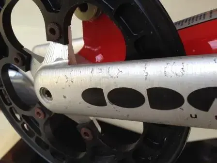

would anyone know how these coda cranks were finished originaly? im thinking clear or silver anodised. How would i refinish them bearing in mind that have steeel pedal inserts and are glued together.

Clear / silver anodised by the looks.
I've anodised the cranks that are two halves glued together and not heard of any problems.
Has a post been deleted?
I've not seen these ones in person. They can usually be sealed with some sort of sealant that won't be affected (too much) by the anodising process.
The later version of these I've seen had aluminium threads.
