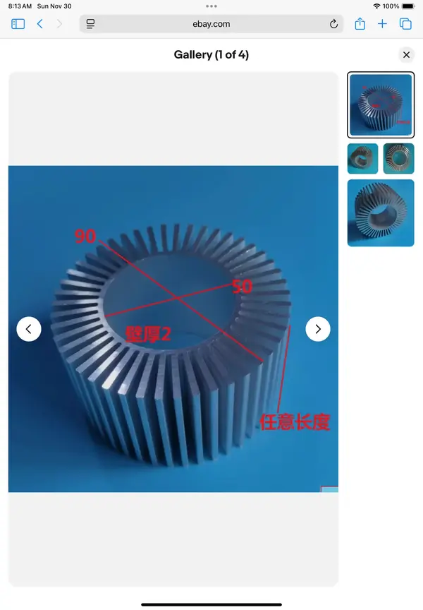

I’ve bought two of these from eBay. The diameter fits the old Morrow coaster, which the repack guys used.

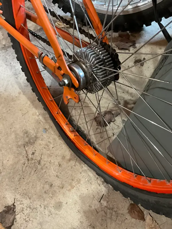

It’s cut in half. Other coasters have a smaller diameter so a section has to be removed and it bent around a mandrel using a hose clamp. It’s too wide so I used a hack saw to make it fit. I filed a groove so the steel cable tie wouldn’t slide around stay put. Here’s one on my Morrow.
