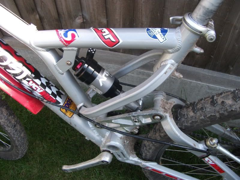

cyfa2809":3dqypipb said:
I measured frame.
Your measurements are significantly different to mine.

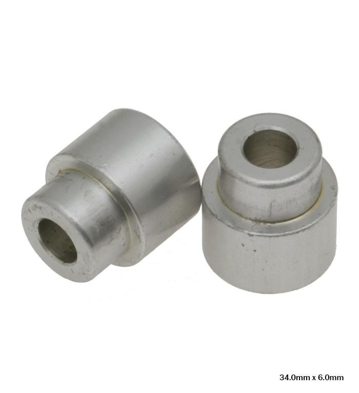

Also, there are no sleves or o-rings on my "hardware", top and bottom are the same shape and look like this;
Ah i see, your hardware is different to mine. Maybe the person you got it off changed it to fit thir frame.
Mine is a central sleeve with washers that go over it.

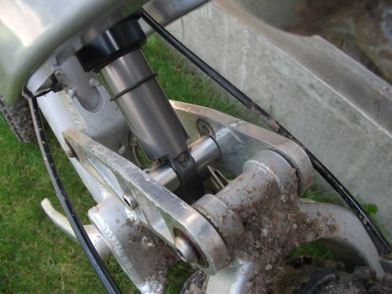

I didnt want to drill my plates (is there enough room to drill the 3 holes to 8mm?).
I've owned this frame from new, the hardware on the coil shock is all original. The air shock came with no hardware, I bought some from CRC.
The top is 22.2*6 and the bottom is 47*8. The bottom hardware is a steel shaft, 12.0mm OD and 8.0mm ID with aluminium sleeves.
I am only drilling the middle hole for now, the distance between hole centres is enough for all three to be drilled, but the pocket needs to be enlarged to get the head of the bolt in.
