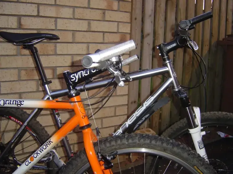

I have been comparing my 18 inch clockwork frame and the new genesis io and am amazed at the difference :shock: I know that the new bike is suspension fork adjusted but could not believe how low my stem and bars are on the orange compared to the same sized genesis. This is prob. not news to any of you, but I stopped paying attention to bikes in 1995.

Have you got the rigid forks on the Genesis IO ? For a start they have an axle to crown length of 440mm compared to the forks on the Clockwork which are probably about 395mm. Plus maybe 10 or 15mm extra headtube length on the IO, and possibly 10 or 15mm of spacers under the stem. Add to that risers bars with 25mm rise and before you know it you could have around an extra 100mm of bar height relative to the saddle.
Of course (heresy content here !) you could always fit a shorter stem and risers to the Clockwork - there ain't no law against it yet :lol:

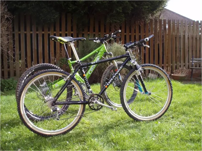

Here are a few pics to show you the difference in frame size angles etc..

I've tried new bikes with long forks, short stems and sit up and beg geometry and I just don't get on with them.
I guess it's what you're used to.
My favourite riding is old school XC; out in the open burning up bridle ways and cool stuff like that.
I guess as things progressed and suspension technology filtered down from DH bikes XC riding changed, There are sections on trails now that wouldn't have been out of place on DH courses ten years ago which is why all these 'all mountain' bikes are so popular (they look like DH bikes to me). When did XC bikes start to 'need' 4" of travel?
The two bikes I have built up at the moment are both rigid, and you know what? I actually like them like that and certainly haven't missed bouncy forks. :?
xc bikes don't 'need' 4" of travel, but it does help my wrists from killing me after a few miles, also sus forks/bikes track the terrain a bit better than fully rigid bikes, meaning more control as your tyres are in contact with the ground more often than with a rigid bike.
