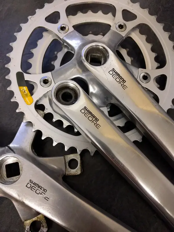

Has anyone used this Clear Transfer Paper with an lazer printer to print and apply decals?
I've recreated the Shimano Deore logo that I'm looking to apply to a DX chainset.

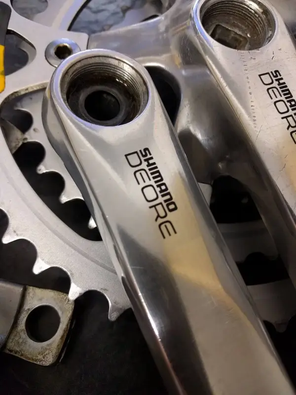

I did some in 2014. The ones on bikes don't spend a long time outside, so I stuck some of my test coupons on the
bonnet of my land rover and they have been in the sun for 4 years. They look fine.
I tried the expensive papers recomended on the model forums but found the cheap chinese paper was better.
I used Hubrol Decalfix or Microsol/set rather than water. I had a problem with decals not sticking, the decals
stuck really well when the products were used and they go flatter.
The process was simple and the results look rather good :D . Not sure on the durability.
