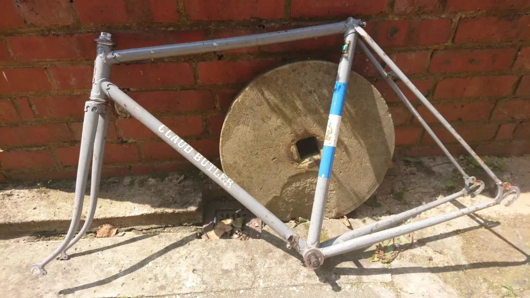

Top tube 57cm
Seat tube 54cm

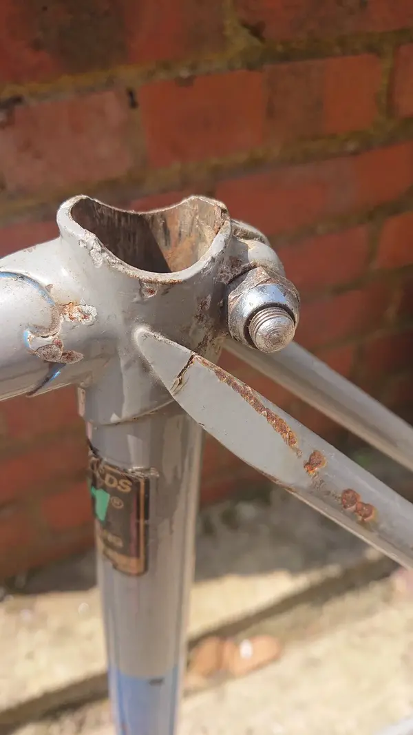

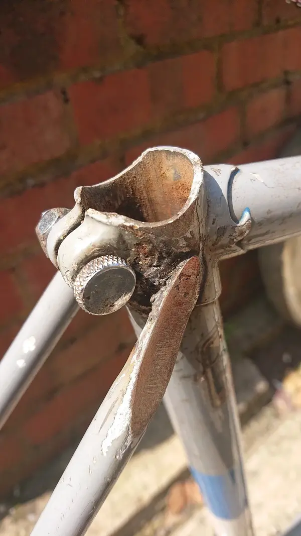

The frame has been repaired and has a crack which I guess is the same as the one that's been repaired, see photos. there's also a bolt snapped of in the rack mount.

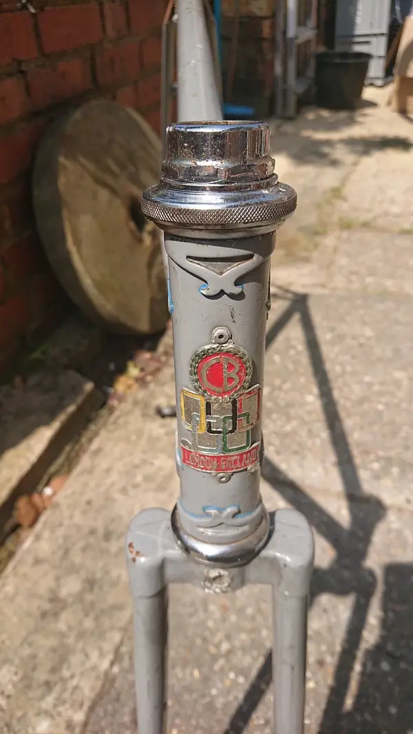

Pop the headset top nut off and have a look on the steering tube part of the forks. It will be stamped clearly on there.
Stamped 4971 which could be whats on the frame I can just make out a 4, there's a faint C on the fork too
Considering its condition and what it cost me I'd happy to karma it, I'm not sure its a worth repairing or do you think it's scrap?
Frame number is from early 1960, so it's one of the first coureurs.. but it's a plain gauge and considered a lower end model, so definitely not worth an Argos paint job, but it's still a quality hand built frame so a weld repair, blast, powder-coat and some correct stickers from H Lloyds would make you a nice winter rider/tourer and although this would be relatively inexpensive it still wouldn't even "wash its face" financially speaking (break even)
