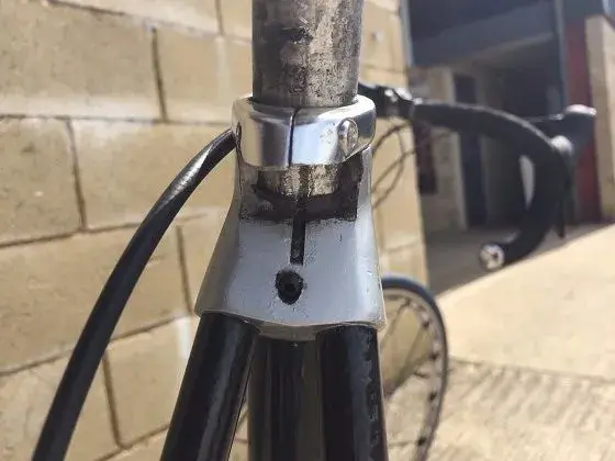

The only damage is to the seat post clamp which has fractured as shown in the pictures, I have the piece that came away so can easily be tig welded or bonded back on but for the interim I just used a seperate clamp which did the trick.

... sorry with a broken seat lug, which cannot be changed today, perhabs LOOK directly will do it - but such a frame set will not have any value. Such a damaged frame set can be base of a wall hanging frame or bike only ... or you should continue to ride it if possible 700 GBP for this has been a really joke :?
Can you explain how the 'separate clamp' held the seatpost in place, when the seat tube has no extension.

The seat lug can be tig welded back on and sanded flush, it does not completely devalue the bike.
I have pondered over selling the bike for ages and have had lots of people look at it and told me if the seat lug was fixed I could expect £1,000 for it.

...sorry but - you need really a lot of passion to find anyone, who will pay for such a damaged frame set.
with such a damage it will be not interested for a classic cycle-collector. And who will buy such an old frame set instead.
For my opinion as a collector of youngtimers plastic (carbon) cycles this will be not repairable by TIG-welding, the seat lug clearly has to be replaced
