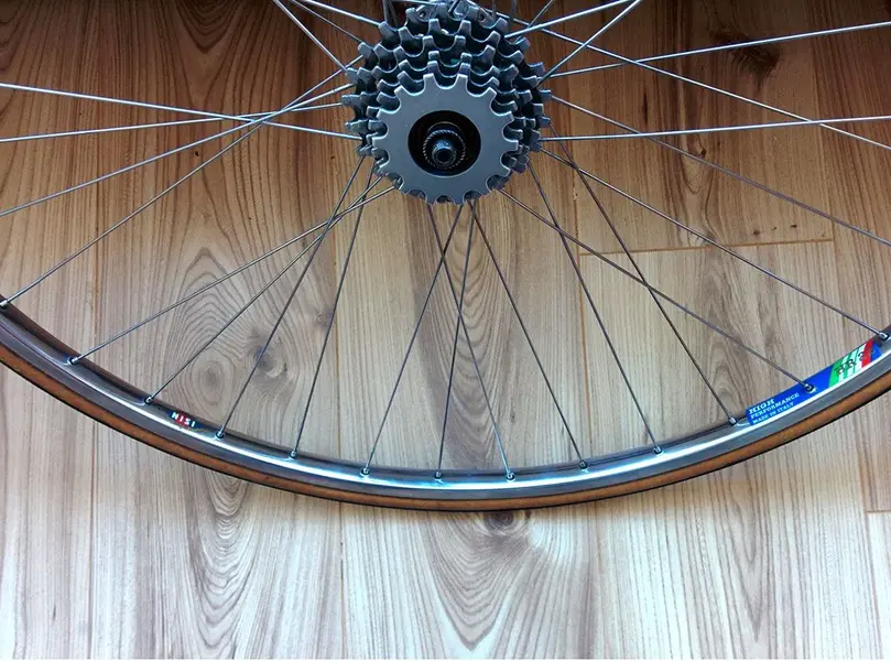

If you ignore the smudges the rims came up well. Just gently scoured the brake surfaces to remove brake marks and polished the tops. It also shows the practically new freewheel, shame to swap it out but a 14-21's just too narrow. Polished the hubs too, didn't need much work at all.

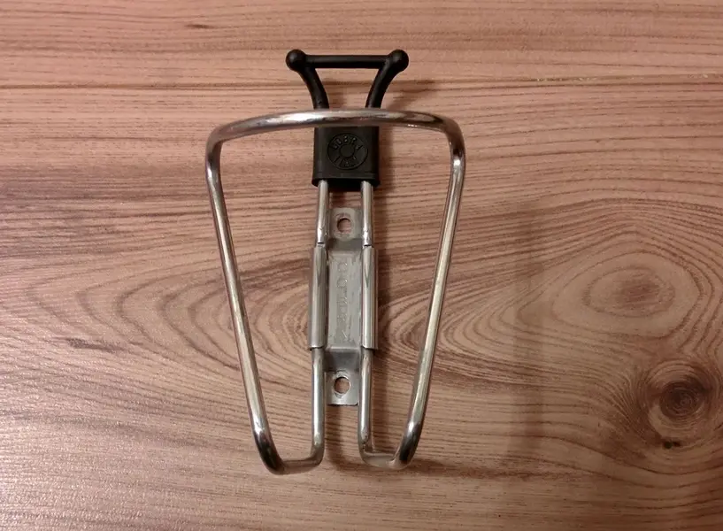

The Cobra bottle cage was red, so that was de-anodised and polished the best I could. But it's really poor quality aluminium so didn't come up great but looks fine from arms length.

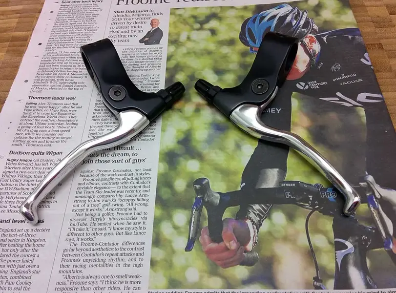

As with the Moser the idea's to have it as a drop bar and flat bar by swapping the front ends. So I de-andoised and polished up the blades on some Dia-Compe SS7's for the flat version. Took far longer than I expected as there were quite a few low areas.

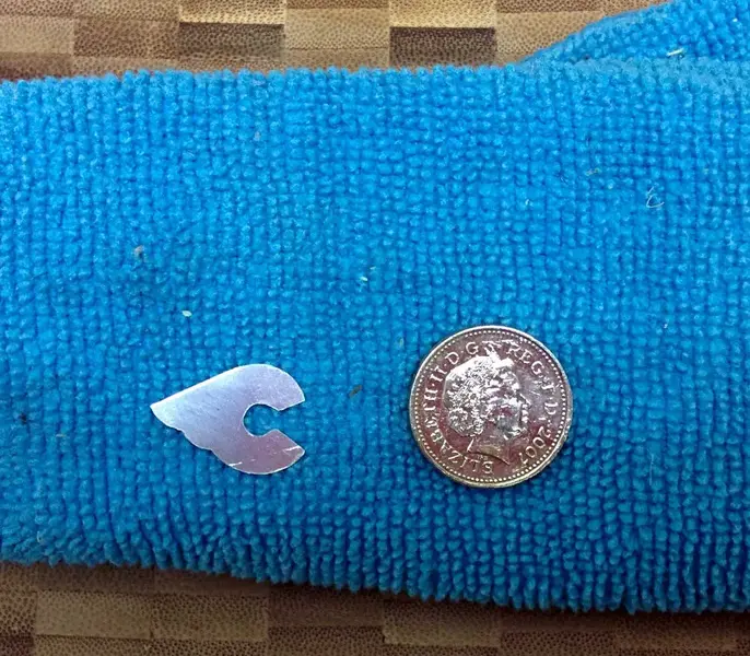

Had and idea of a small badge thing for somewhere like the stem. Was going to saw insets as per the logo then fill with enamel, not sure I have the skill to do that though.
I used a piece of sterling silver sheet and the pic shows it before tidying next to a pound coin, so the insets would be tiny and I'll just end up snapping it.
Might still be able to use it for something as is (but tidied up), it would age differently to aluminium so might work OK.

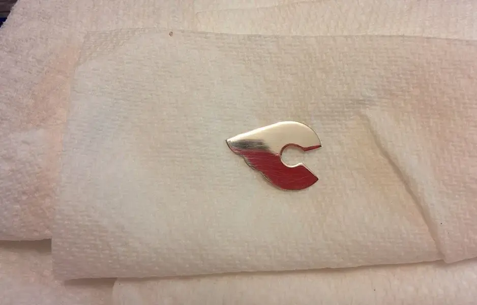

The light picked up every micro scratch, so need to do more polishing but it looks ok. I'll find a place for it.
