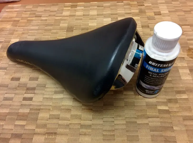

The Tornado Targa saddle looks too big in comparison with the tubes and the frame size, probably looks fine on something larger. So, as the last 3 builds all had special edition saddles I though we'd do the same with this. Brand new and modern this time but fairly classic looking, a Brooks Cambium C17 Denim. It's a touch lighter and you can see a a bit more variation than in the photo.
As the fabric is from donated old jeans I said what I didn't want, really faded or with very contrasty fold marks, didn't want a blue zebra look.
It just arrived, number 112 (as with others marked on the front rivet), and looks good, just enough variation and dark enough. The Brooks badge at the back isn't anodised so just had to give that a really quick polish, makes the lettering pop out a bit more.
Got a free pair of plugs, think as I'd signed up to their newsletter.
Had thought about a C15 but think this will work better.

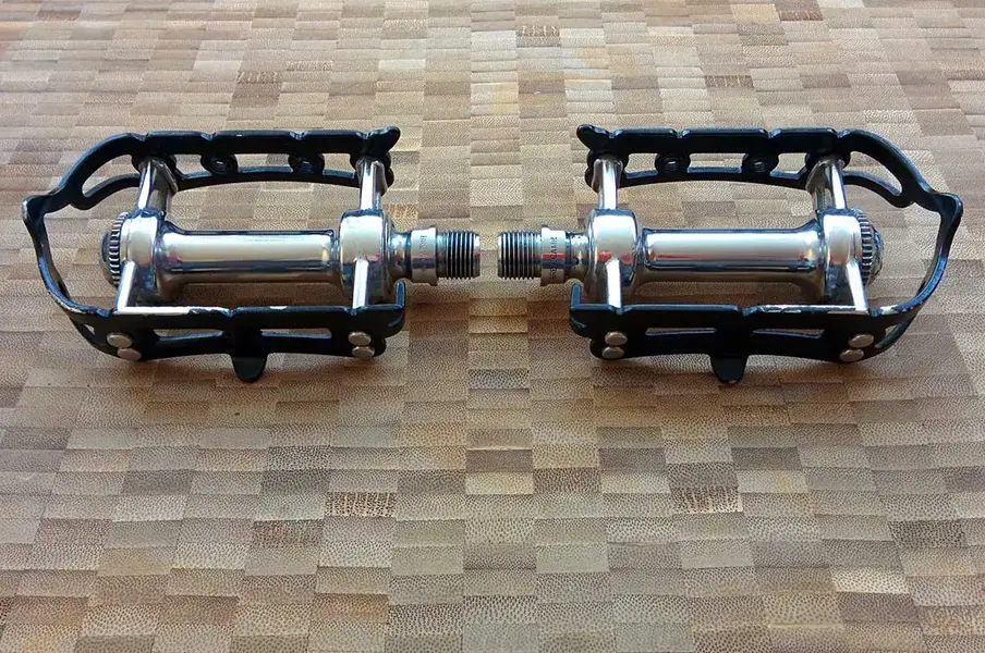

Also still need to finish rebuilding the Record SL pedals but my brother was having problems with the bearings staying in place. Not had a go yet so not sure exactly what he means. For now it has Look PP396 Jalebert's on.

My brother's going to take the Campag pedal over to Harry Rowland and see if he can work out what's wrong.
The Look pedals just didn't suit the bike so we've put on the Grafton Speedtraps which are really for my Adroit.
They're NOS and I polished them up a bit, 2 minute job. They're without the clip in gubbins and we had to file the strap holes ever so slightly to fit in the Binda straps. Think I like them more than the Campags but the Campags will go back on if it ever go back together.
