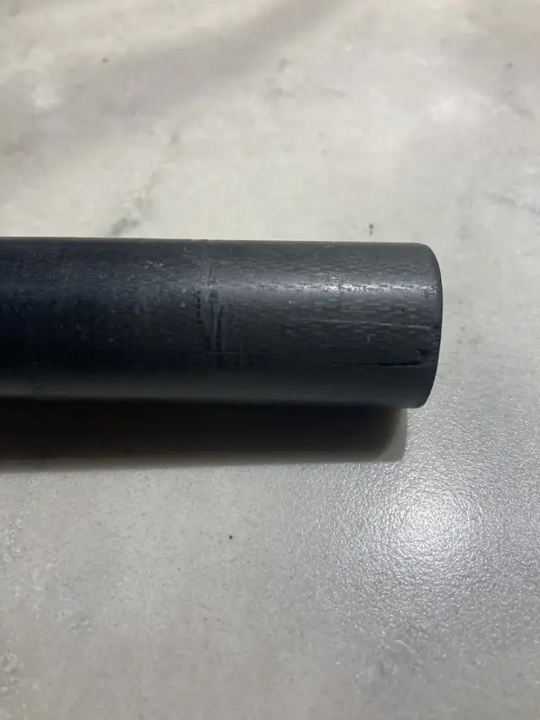

Hard to tell from the pic but i guess that is the outside of the top of the steerer?
That vertical feature is either a fracture, or maybe a seam from a mould?. Depends how the steerer has been made, but i thought carbon steerers are tubes and not made in moulds. Anyway; if is has been made in a mould then the mould line will run the full length of the steerer. If it is only local to where the star nut has been then there is a good chance it is a fracture and it is time to chop that bit off, for a smaller frame.

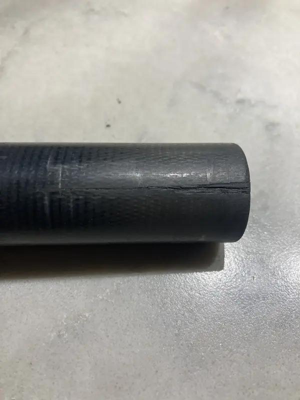

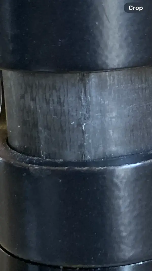

I did the carbo tap test with an old lira coin and there was a dull thud in the spot. Says it all I suppose.
You can't rely on a tap test anyway. If the star nut is still in the steerer that will change the frequency of the tube and you also need a tube that is 100% ok, to comapre against. Pretty sure that due to the nature of the material you would struggle to hear the difference between a tube with a few fractured strands and a tube that is completely ok and It is those few fractures that can become more, with carbon, and then it can just snap.
Curiosity got the better of me. I think we will be in agreement.

Holy sh!t !!
You should go stick the pointy end of that fork up the mechanics arse and then follow his advice and bang it home another 10mm.
Anyway...now you get to buy a nice new fork :)
