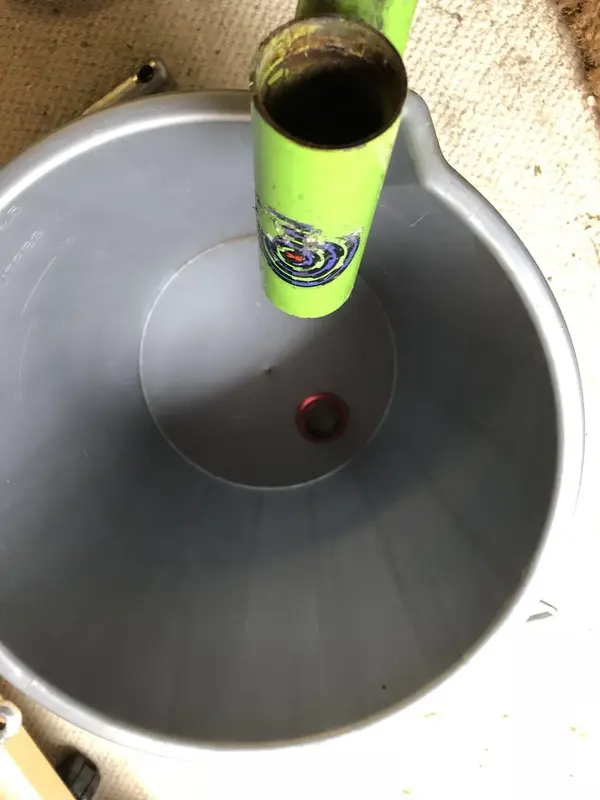

I was think about this...
Using my own special tool, voila, it’s safely removed and carefully caught before hitting the ground!:

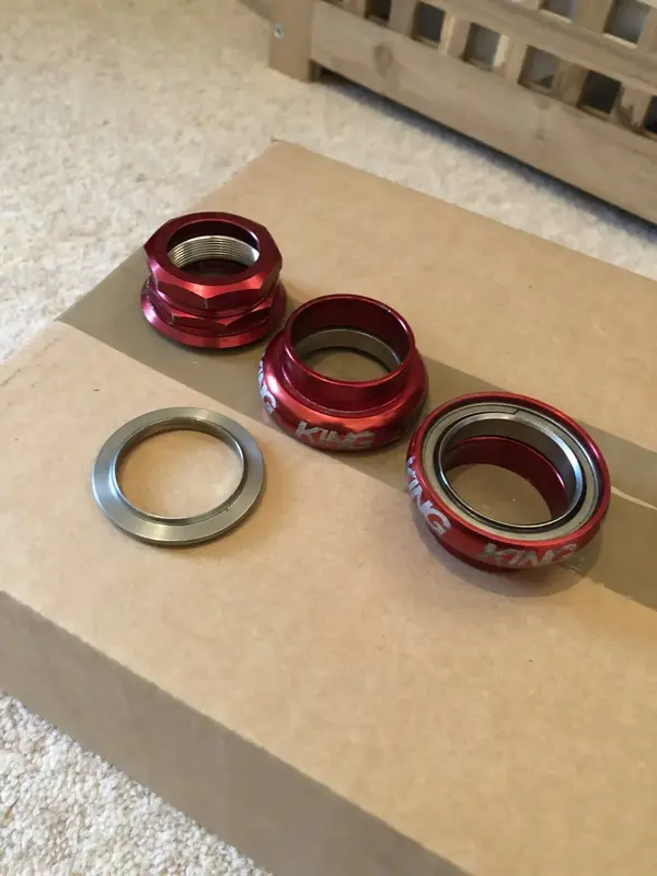

And the finished article ready to sell:

8) what is the special tool then? did you just use the hammer handle? You dont need to catch the cup, unless you are removing it on a 18th floor balcony :shock: :lol:
mark
I used the wood, and hit it with a hammer.
They fly off quite quickly and usually end up the other side of the garage covered in fluff, hence the bucket. Plus I thought it was suitably irreverent

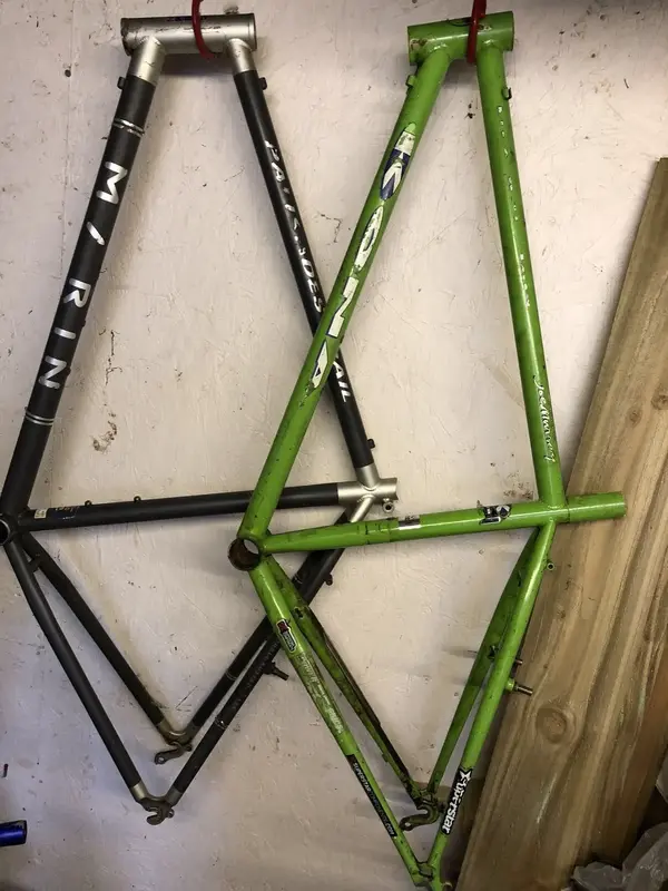

Tricky1977":1v8a3ozt said:
Pic of said headset:
Not sure which type it is... it has two bits on top, but neither seem to do much
And yes that’s what I thought about the LBS too.....
Nice RAD Components canti straddle hanger.
P.s. Your tyre is on backwards.

Thanks (on both counts), I shall be putting the hangers up for sale no doubt :)
The bike was very well kitted out for a basic frame and now has pride of place on my wall ;)

Out of interest it’s ready to sell but I can’t figure out what size it is... the ID of the bearing race and coloured piece is bang on 30mm which isn’t 1 1/8 or 1”. Am I doing it wrong or is there some clearance?
Thanks
Coloured piece?
They are all coloured pieces?
And the ID of the bearing doesn't actually run on any part of the frame, so the measurement is not really much use.
You really need the OD of where the cups fit into the frame or the ID of the base plate.
