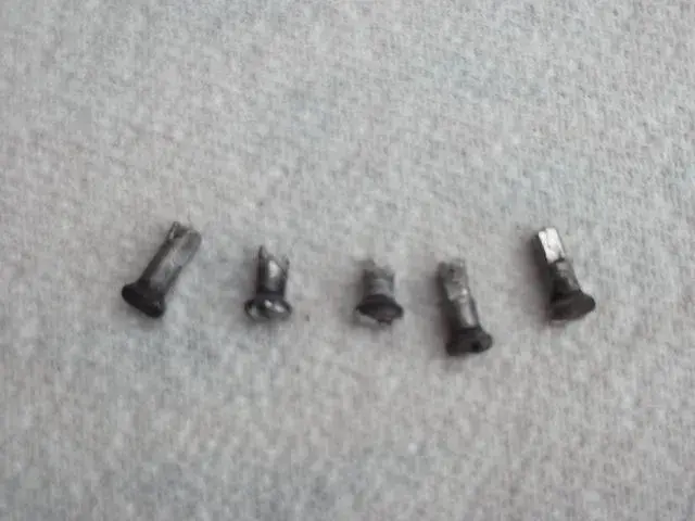

Here's what I was dealing with ,

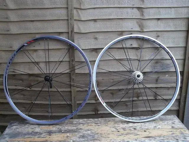

Varying state of knackeredness , which turned into . . .

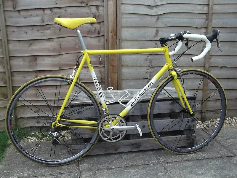

and rolling again 8)
Thanks for all your advice , much appreciated :wink:
