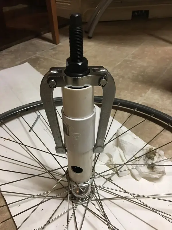

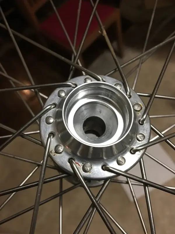

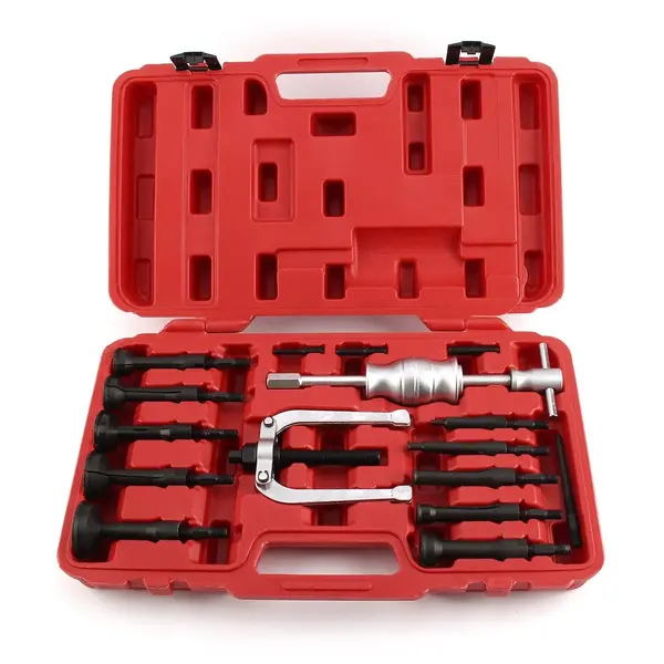

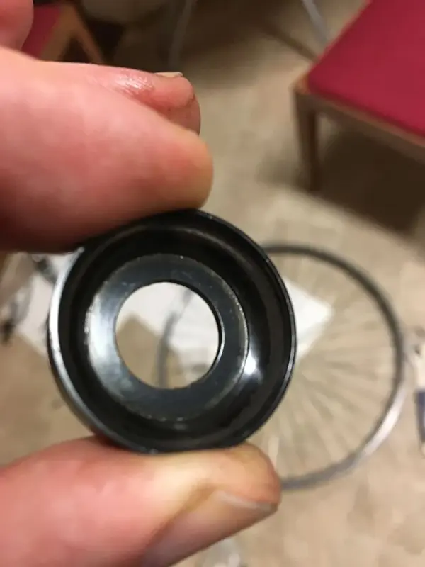

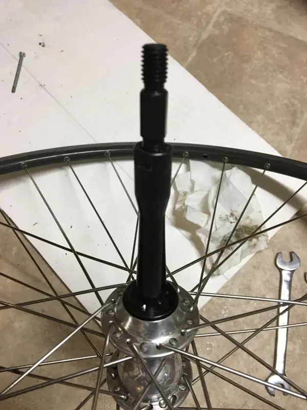

A bit late to the party but I've just removed the cups on a Record 95 hub. I borrowed from the method shown on bikeforums. I bought a bearing puller kit on ebay. Cost about £38. It worked out very well. You can see the method I used in the attached photos. I could have bought a cheaper set but I wanted to get both types of extractors, not just the slide hammer and I'm glad I did.
If anyone buys this kit then I found I needed to use the second size tool but couple it with the third sized threaded expander rod. With the number 2 expander rod it didn't expand the jaws wide enough before the thread bottomed out.
I used a bit of standard bathroom drainage pipe as support for the tool when assembled and it allowed me to use the threaded extractor. I found this much more smooth than using the slide hammer.
I'm not sure of the longevity of this kit as it looks to be of chinese origin even though it shipped from UK. The jaws are expanded and contracted with every use and over time it's possible that the metal will fatigue and crack. The Cyclus tool will possibly be more robust even though it looks to be a similar design. Having said that I would be surprised if I don't get 20 to 30 more uses out of the tool which will hopefully be more than I will ever need.
Looks like you got a lot for your money with that set.
