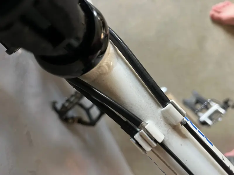

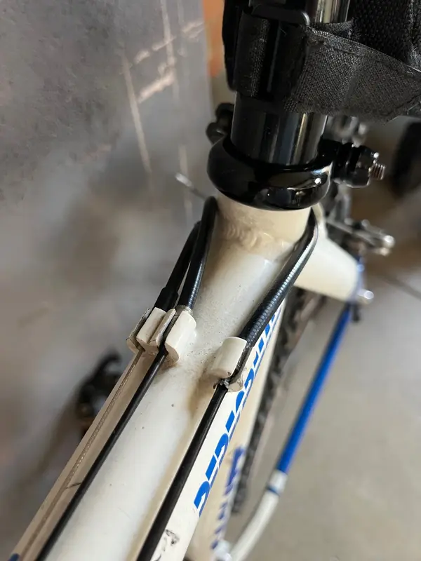

I hope this makes more sense, 1st image you can see the lovely thick brake cable housing (coil style) on the left as you look at the image, then the none coil style shifter cable housing in the middle still wide diameter, then the newer style super thin cable housing on the far righ. But then 2nd image on the right the coil style brake cable housing (coil style) then middle, they have use the coil style cable now for the gear shifter. I'm guessing this doesn't make any difference to the shifting if the housing is the coil type or not?
Final shot you can see the difference in brake cable housing diamater to the middle shifter cable housing and then the newer style thinner housing on the left. I desperatly want to try and source these 2x old style super wide diameter cable housing?

Ahhh ok, do you know from looking at the last image if they made that coil style cable housing for shifter cables back then? as its thinner in diameter to the brake cable housing, so i'm presuming it is the correct original cable housing for the shifter cable?

Honestly, i cant remember what the gear was bitd! It would be early "m system" stuff wth xt kit.
The brake was deffo, as you say, the bigger "rope" 2mm inner. They also made fatter hangers and straddles to compliment it.
The may have been stranded....ie running along the length..but my memory is shot to bit now....87 was a loooooong time back. 🤣
