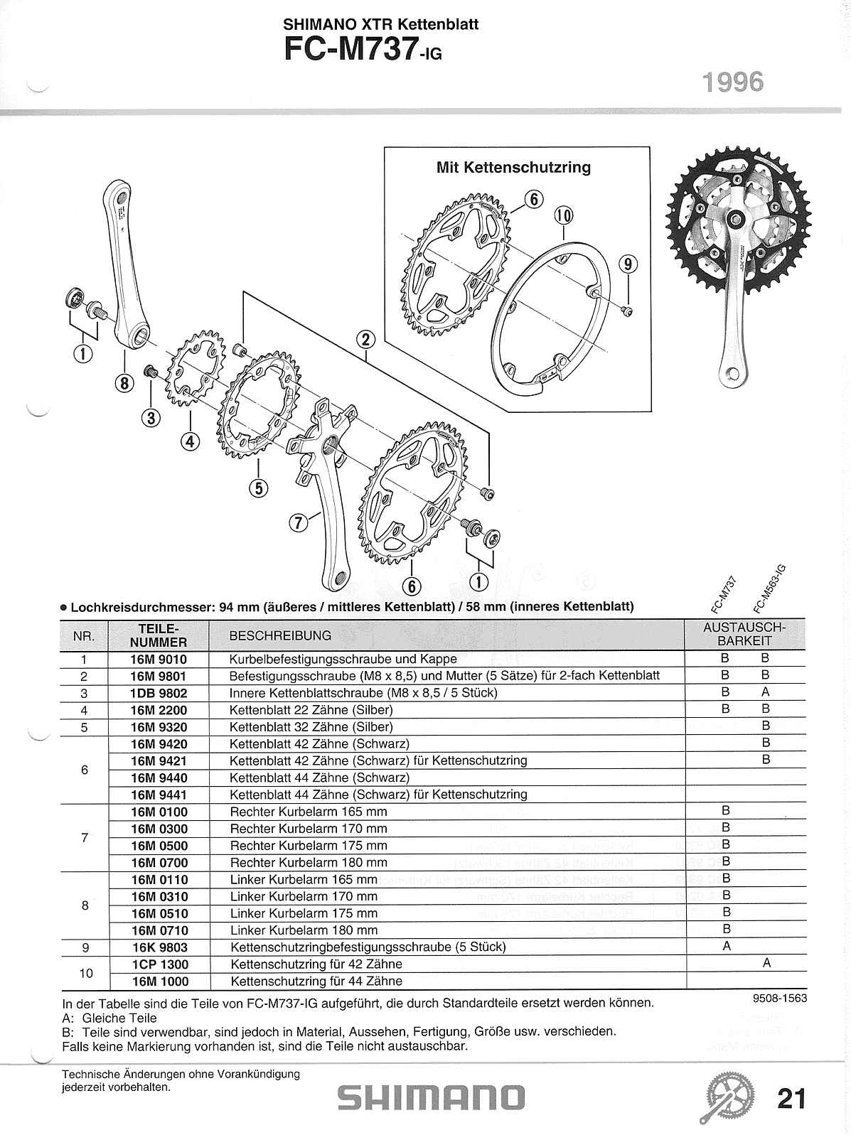

"stock" spindle length for the M737 is 106mm so i would assume that the problem is due to a too long spindle. distance of the chain rings is pretty much fixed by the spider. no washers etc are required - except maybe for those very thin ones Shimano has used to fine tune the centering of the rings. just bolt the rings on and you're good to go.
what ring sizes are you using?
Carsten

106!!! Not with this FM - I've always found conventional-swing FMs have more clearance to the rings, so maybe that's what I need to use here.
Many thanks for the picture Carsten, will copy that.
