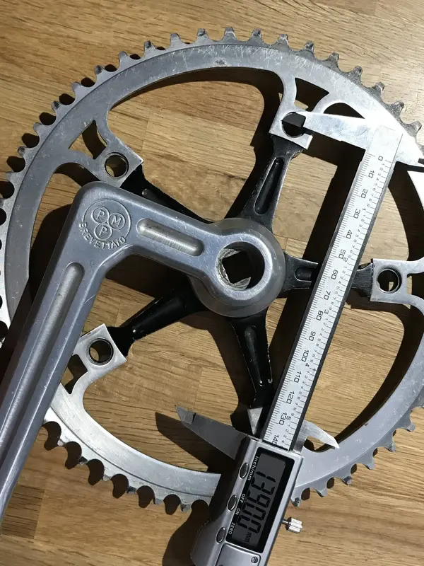

Thanks for you’re feedback guys, I’ve attached a pic, its easy with a 4 bolt but it’s guess work with a 5, how do tell that it’s not 138 or 140? I could print out some circles to help follow the line but it’s still slightly guess work, there must be a better way, ie the tool

I appreciate it’s a branded crank so I could google it but I have this issue all the time with obscure chainrings / cranks
Just measure between the holes and calculate or use Sheldon to get the bcd. Or print out the sheets from Sheldon (I hadn't seen them before, I think they're fairly new)
Yes, that’s fair enough, I can use the formula to calculate, looked a bit complex, maths never my strong point, am just being lazy! Thanks for your help 👍 appreciated
