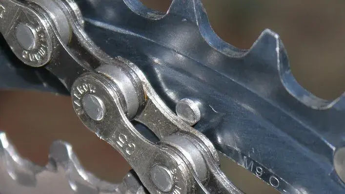

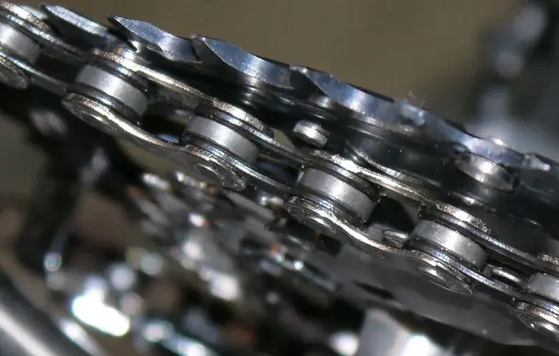

Pics hard to illustrate the problem, but you can see how the pin is contacting the chain....

Mmmh. I think in middle ring, small rear sprocket some touching is ok, but the picture "ring 3" is too strange for a full
Shimano set-up, especially if all the rings are standard sizes. Just a thought, but it may
be an idea to check your frame for alignment at a LBS, and to actually see if the BB is on square rather than crooked.

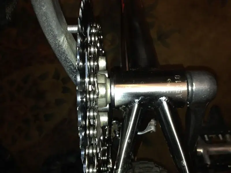

One thought is that the drive side crank arm is close to the frame BB...maybe Sheldon is out on this one?
Doug
