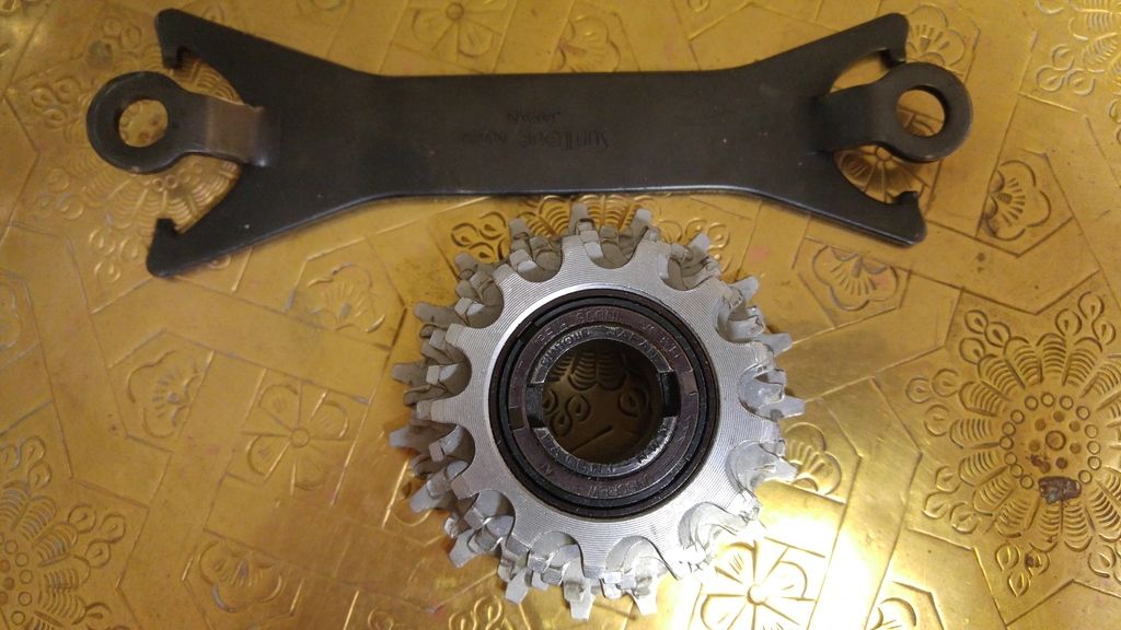

Ok, I'm convinced. This is the item I bought with what would be an "economy class" freewheel:
http://www.ebay.co.uk/itm/27x1-1-4-MULT ... 6vfB0NOqCA
The freewheel that's on it is 14 -28. I would like a smaller sprocket for the highest gear, and found this:
http://www.ebay.co.uk/itm/SHIMANO-FREEW ... Sw3ydVpQ2I
I take it that should do the trick?
Those are freewheels not cassettes, the difference between the two is far from academic or pedantry.
Please excuse my ignorance. I have only just learned what the difference is, and have not argued that it is academic or pedantry.
The "new" freewheel is clearly not new: the wear is obvious.
I bought it new on 1/3/16.

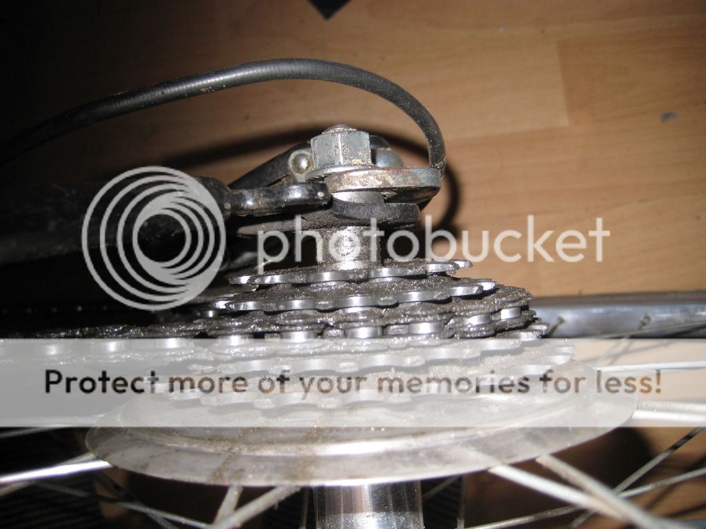

When you change 5 speed freewheel for 6 or 7 you may have a problem because 6 or 7 speed freewheels are wider and you may not be able to fit wheel back onto the frame or the smallest cog could rub the chainstay. In that case you would need to add a spacer between cone and locknut on the drive side and redish the wheel.
Wheels for 5 speed frewheel are designed for use with wheels that have 120mm spacing, 6-7 would probably need 125 or more.
There is 123.4 mm clearance (measured with rear wheel removed). The old 5 speed freewheel seems to have quite a large spacer as it is.
I imagine I could probably "persuade" the 123.4mm clearance to be another couple of mm wider if necessary, and would hope a slightly wider freewheel might fit if I use a smaller spacer.
That seems to be a lot of space. 6 speed frewheel should be ok, maybe 7 as well...
according to this: http://www.bikeforums.net/bicycle-mecha ... width.html 7 speed freewheels had the same overall width with narrower spacers between cogs
'standard 6 adds a cog, with the same spacing,
so frame spread went to 126.
7 speed, thins the gaps between cogs, to get the extra cog in a 126 frame'
Suntour "Ultra-6" narrow spaced 6 speed freewheels put six speeds in the space of 5 and fits with 120mm OLN. The ultra spacing is 5mm instead of the 5 speed standard of 5.5mm and uses 7-8 speed chain (5mm ultra spacing was adopted as the standard for 7/8 speed freewheels). I agree with Predki, it looks like a 6 speed standard freewheel will fit and a 7 speed freewheel will probably fit, might be worth a try.
http://www.sheldonbrown.com/suntour-freewheel.html
: Mike
FWIW some of the really cheap cassettes/freewheels are made from some never before seen "metal" that corrodes faster than aluminium in coke and is softer than plasticine.
We had an old guy who used to come into one of the shops i worked at to have a new cassette put on about once a month. They were all utterly destroyed, but only a few weeks old. He was happy to pay a tenner to have them swapped, as he was paying about 5 quid for them from the market. The half way decent one we eventually fitted (cheapy regina IIRC) cost something like 25 quid and lasted a couple of years.
Bit of a false economy. Paying 150+ quid in parts and labour for the cheap stuff, or 30-35 quid to have something halfway decent fitted once every two years............
The space between the smallest cog and the frame in the picture above would tend to suggest the frame is actually 126mm and you could put a normal 6 speed freewheel in without problem?
