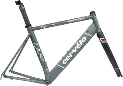

Anyone interested in a cheap cervelo soloist frame? small sizes only 48cm + 50cm available 2008 model, in team colours

They look a bit sketchy... Google search suggests the Soloist Team 2008 should have an oval seatpost, and a way more ovalised downtube.
Real thing has straight chainstays too.

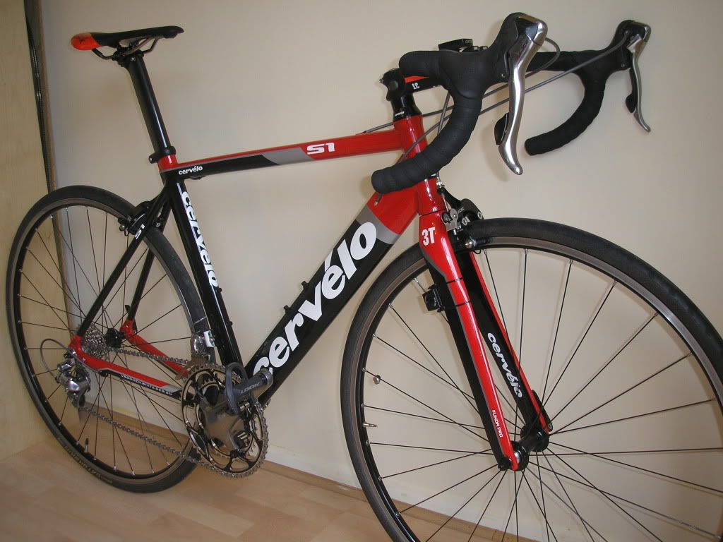

bought an s1 2 weeks ago and love it to bits :roll:
has straight stays and oval seat and down tubes also has internal cable routing.
hope this helps
Yes... that is absolutely a fake. :cry:
*backs away from the deal*
Thanks a lot guys, you just saved me putting out 750 quid for three fakes then. I was blinded by wanting one!
just looking at the advert it says frame weight 1721 grams, mine is 1472 for a bigger frame, i am inclined to think that this is not a cervelo frame at all, and it is very cheap. just dont want to see a retrobiker being had by a villan trying to make a quick buck :wink:
