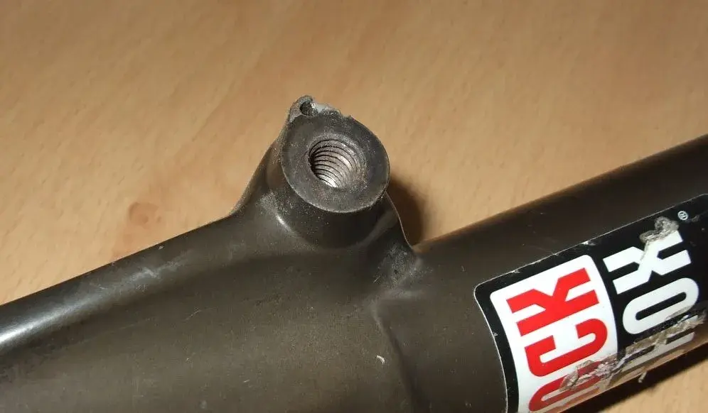

Incidentally, this is why I have to get into discs. I had a tragedy with my (I think fairly rare) raw-coloured 2003 SID.
