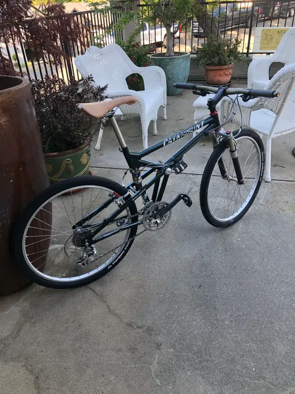

Catamount MFS

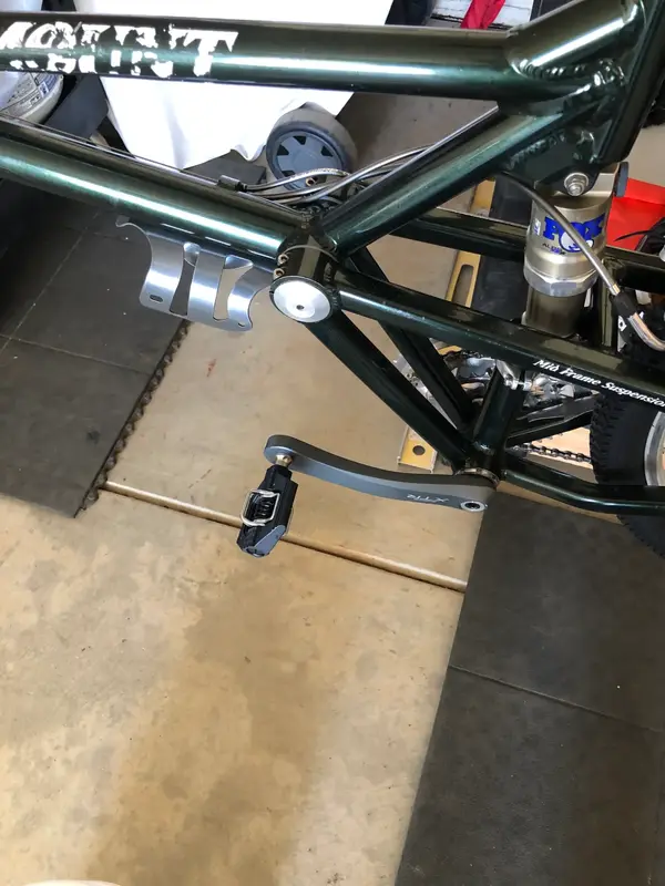

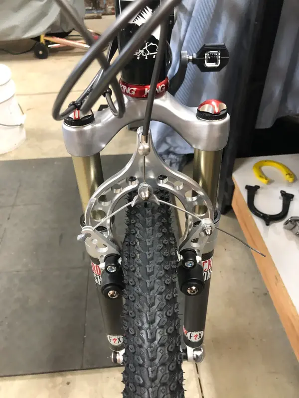

Pedals with ti spindles, brake close up and cut steerer.

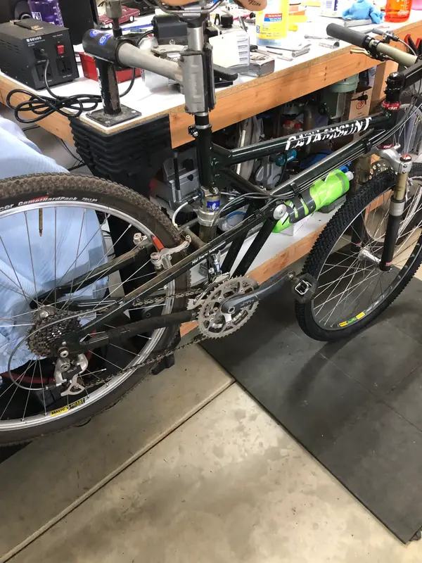

Shock holds 200psi. Riding on it will tell the truth.

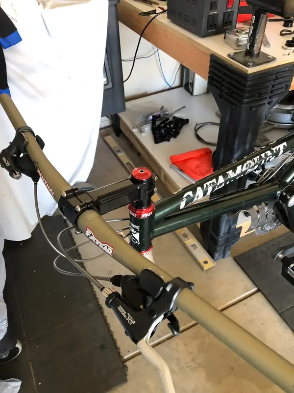

The cockpits a bit cramped. I suppose I could flip the stem and move the seat back a bit. Might gain 1/2”.

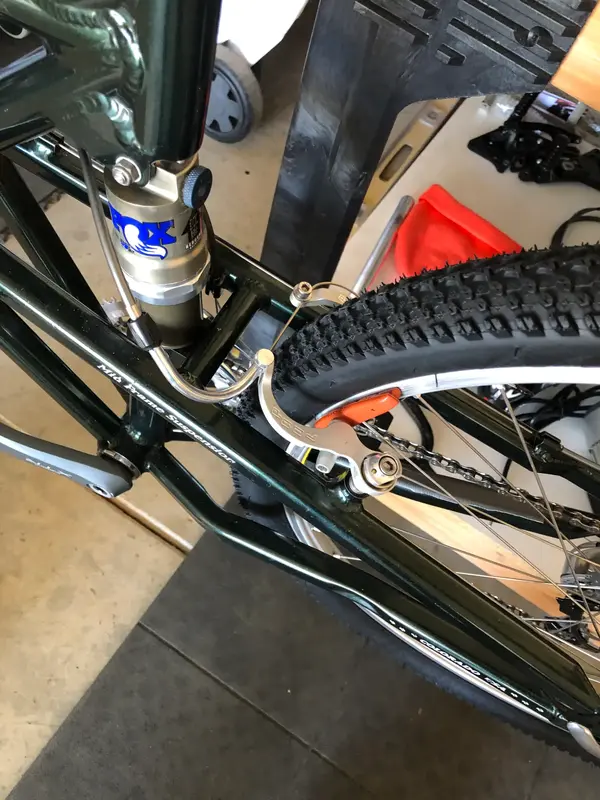

I’m going to change out the brakes. The mini motos tire clearance is marginal at best with 1.95’s.

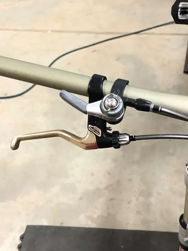

I’m going Th change out the rapid-fire/brake levers and use thumb shifters/XC pro combo. Maybe less clunky looking.

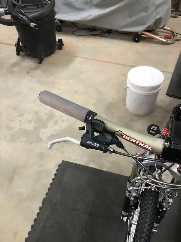

Now to get the grips off. I use hairspray when I install grips. IMG_1311.webp

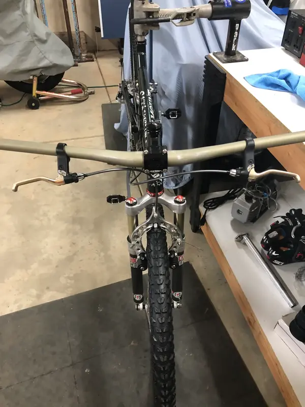

Took it out on its maiden voyage today.
Man it’s hard to stay seated when your so used to standing.
Shifting was flawless. Front brake squeaked. Seatpost needs a shim. New pedals will take some time getting used to. I had 1 tip over.
Rear end is amazing, what bumps. Forks seem a bit stiff but it could be I was slow after 15 days off a bike.
The different front tire stuck well.
Overall very pleased.
