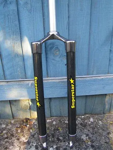

Hi and welcome along!......superstar components do a reasonably priced and lovely carbon fork too.....

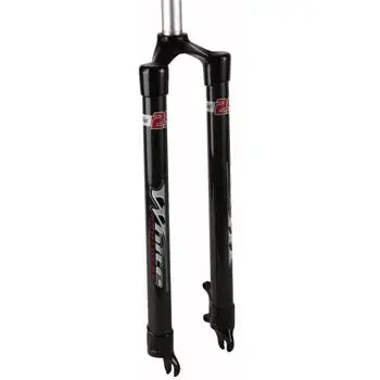

The Exotic and Superstar forks are the same fork :wink:
as is white brothers and others
just branded differently

Thanx, they certainly look the dogs.Im sure they will make the bike feel 'livelier' too.
My Pantera has a 1 1/8 steerer, but what length should i go for? As I said before, i had a set of old judys on it before, so what should i require to keep the bike at the same angles(?).
I think that these are the shortest that they do
http://www.ebay.co.uk/itm/eXotic-Rigid- ... 2eb8534463
42.5 which equates to a 100mm travel fork i think, you might want to check the axle to crown measurement on the judys to see if you will get away with it, and maybe use a shorter stem to compensate for the slacker angles.
I cant find the v brake specific ones on the exotic website, so you might end up paying a little more though

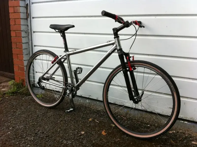

Exotic aluminium fork (425mm A-C) on my Gary Fisher Singlespeed - really good fork for the money...
