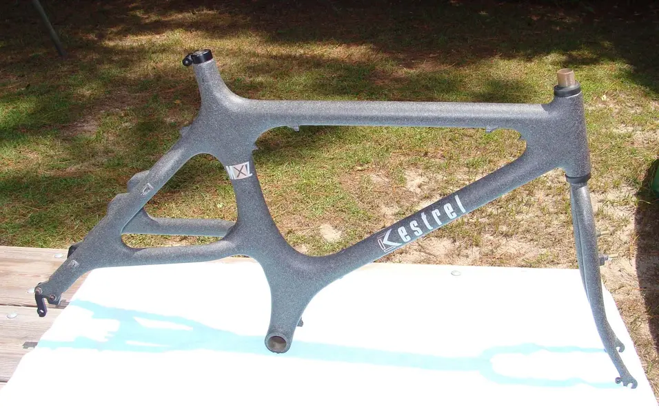

I have worked in a composite R&D shop and have made several items out of various epoxy and fibre combinations. I have also had the chance to find the failure point on composite products Composites are great for some applications but not MTB's, in my opinion.
I still have a NOS Kestrel MXZ F/F. Thought it would be a waste to build something I did not trust.
