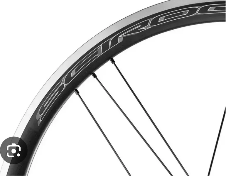

I've been thinking about this for a while. I'm not sure you are right.The wheels would be stiffer and stronger with the opposing spokes pulling at the rim in the same place - like the classic rev-x
They must have known this - it doesn't take an engineer to work it out - so i suspect they were using standard (multispoke) rims or manufacturing processes forcing the webs to be offset.
I see your point, and believe you could design a rim to carry this loading, although even the campagnolo bora/sciroccoI've been thinking about this for a while. I'm not sure you are right.
View attachment 972430has opposing spokes - and it would be hefty,
but this here rim is clearly made for 32 wire spokes, so will suffer a lot of lateral flex under side loads with only 8 spokes
- the rim will push on the carbon strap
- I doubt it's as stiff under load than under tension.
My usual Occam's razor is... if it worked, we'd be using it already
