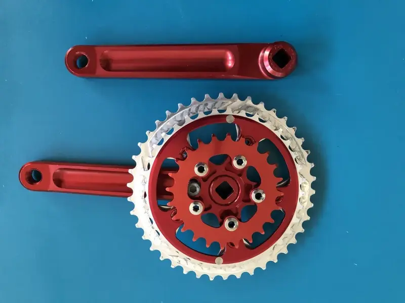

Here is a Topline crank and a Caramba crank - they are built the same with the similar size spacers for the granny ring with the long chainring bolts
Heck, I could have used any boutique crank from that era but I know Toplines and a few others
they all require a long axle
depending on frame material, it will be at least 122.5mm.
They are very similar sizing to XT M730 chainsets which require the same size BB on certain frames.
You havent said what frame so you will have to decide between 122.5, 125 or 127mm

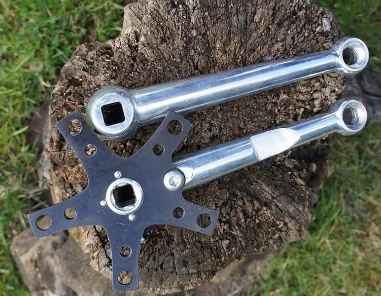

To give you more 'help' these Kookas are built the same as your Carambas but the spder is designed for a narrower BB axle. If you look at where the axle goes in, the Topline/ Caramba are flush whereas the Kooka is raised.
