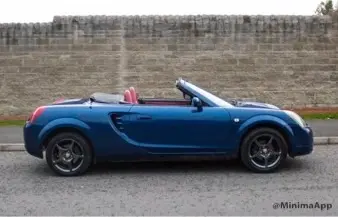

Here’s the ‘beast’ btw...

oooh, a mk3, didnt have one of those but the aerial is easier to convert to DAB, its a straight swap (shiny laptop screen! missed the MK3 bit!)
