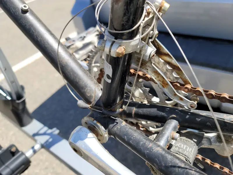

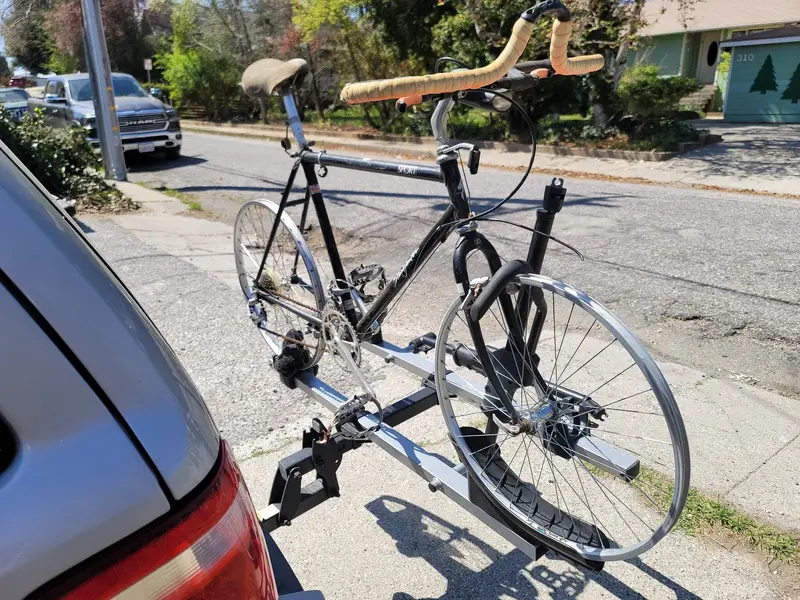

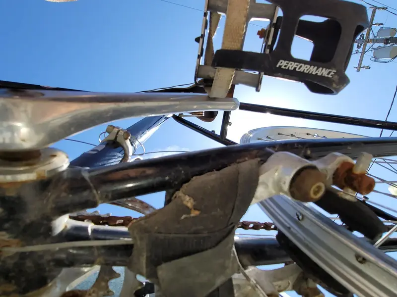

Now you got me thinking it's maybe something other than a 1985 Stumpjumper Sport? Stickers say stumpjumper and sport. Has S in the top of the seat stay, has dear head derailleurs. I noticed that the S is not on the top curve of the forks? Does definitely have a U brake...

Looks like Deerhead cantis and Suntour rollercam. The M733 levers will work just fine
So probably a rebadged diacompe bit of kit. If i remember correctly, they made all their brake components for them?
Cool Outland roller cam boot 8)
