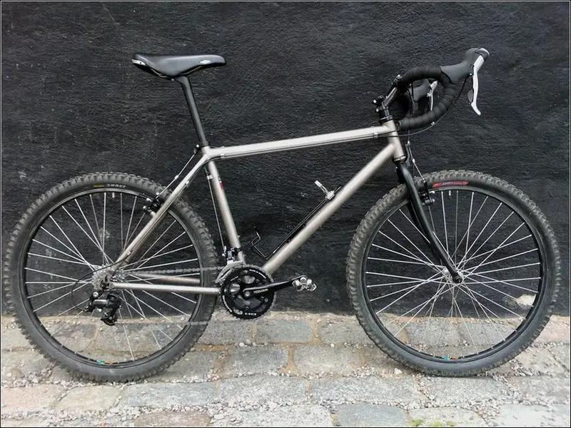

Right now I'm using some 20 year old LXM56x cantis in black with Tiagra ST-4600, but upgraded the pads
to modern cartridge types. I'm very impressed with them, can lock the wheels with very grippy tyres no
problems from the hoods (see picture ;-) .... I may get shot by posting it on the road section).
I've also tried Mini-Vs with flat-bar levers and they were good too. At some point I will be using them with STIs
for another build on the boil, but I have heard they work very well.
I think the secret with cantis is to set them up properly with the correct straddle cable length, proper angles, and
get rid of the older mushy fat brake blocks.
Campagnolo and Tektro do Mini-Vs in black. As for fork judder - apparantly - it is more to do with where the cable
stop is; the lower the better which basically means fork mounted. Having said that, on my CX the cable hanger
is above the headset, and I'm using Tektro cantilevers with no judder.
