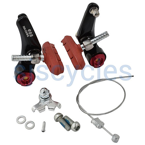

http://www.sjscycles.co.uk/dia-compe-dc988-cantilever-brakes-black-prod18258/

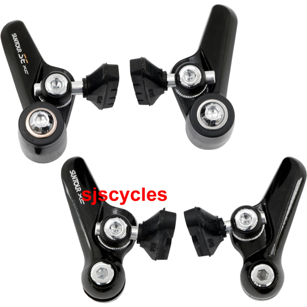

http://www.sjscycles.co.uk/suntour-...antilever-brake-set-front-and-rear-prod18982/

the 988's were ok, i had a pair of them for a while, the pads (pictured) were quite poo though. personally i would suggest a set of shimano dx canti's, the lo pro versions, i think they look nice and the work pretty well and they are not the self-energysing style that diacompe and suntour used which i find can be a faff to set up.
also the dx ones come up very cheap and quite often. they date from 92(?) i think.
Both decent sets of cantis.
I'm going for the Suntour option on my Mayhem 2011 build.
I have used Diacompe 987 (not sure of the difference) in the past, the one fiddly thing with them is the balance adjustment. Rather than being a small allen screw like on Simano and such, you need a spanner (15mm iirc) to adjust them between the back of the brake and the canti stud. I always found it easiest with a cone spanner but you don't always have one with you if something goes untoward while you're out there on the trails.
I received those very Suntour Canti's in the post from SJS this morning and I must say I'm impressed.
Judging by the sping tension when I was setting them up, I'd say they were very powerful brakes, but I've not ridden them yet so can't comment fully. 8)
I have the 988's too, but they're still sat in the packet, so can't comment at all... :roll: :oops:
