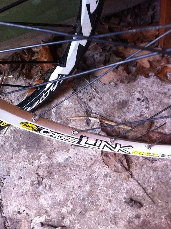

I had one of these & although it had disc mounts it came fitted with Magura rim brakes as standard, has in not got mounts to take V brakes?
It doesn't have mounts for any other brakes. But it does require a new fork, as this one is bent. However, having looked at the disc brakes, it looks simple enough. The question is, how do I find a suitable fork? How universal are they? How do I know if I'm buying something that will fit? and is this frame and components worth spending any time on?

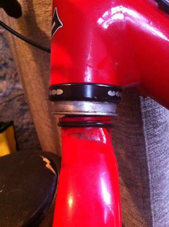

Thanks a lot for your reply. Yeah the fork is bent. The guy I got it off said it had been crashed. You can see in this photo. I think it's the head tube reducers aspect I need to look into. I'm not prepared to bother with learning about the Headshok repair. As you say, sounds like a bit of a mission if you don't know what you're doing. Does a MTB fork and headset come out much like on a road bike? Is there anything I need to know before I go yanking on bits?

Aye, that's bent all right.
To get the headset bearings out first you have to remove the stem off fork and support bike off the ground minus the wheel. Then hit the top of fork with soft faced mallet downwards through bearings. Be careful as you don't want to damage the top cap on fork. It might take a bit more of a hit to get it out since it's bent but you'll find that bottom bearing tends to stay on fork allowing fork to drop all the way through. You'll need to catch it so it doesn't hit yer foot. :mrgreen: The bottom bearing cup will stay in frame and both cups can be removed like a MTB/road bike headset. Again be careful as the part of cups in frame are thin and easily damaged.
From memory there are 2 types of reducers for headset, one that fits into the existing bearings in Cannondale headset and the other type fits into head-tube itself then 1"1/8th bearings can be fitted to it.
I might, not sure, still have a set of reducers but not seen them for a while as I've fitted Leftys to both my Super V and my F800. Will need to have a rummage amongst my pile of crap, er stock of parts.
