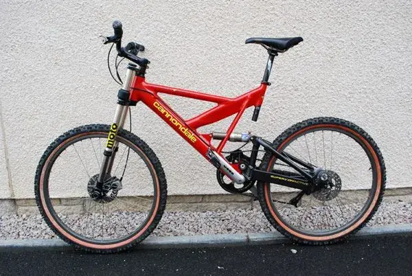

Cannondale Super V DH4000
Hi, Here is a pic of my DH4000
You can see more in my gallery
Hope you enjoy!
