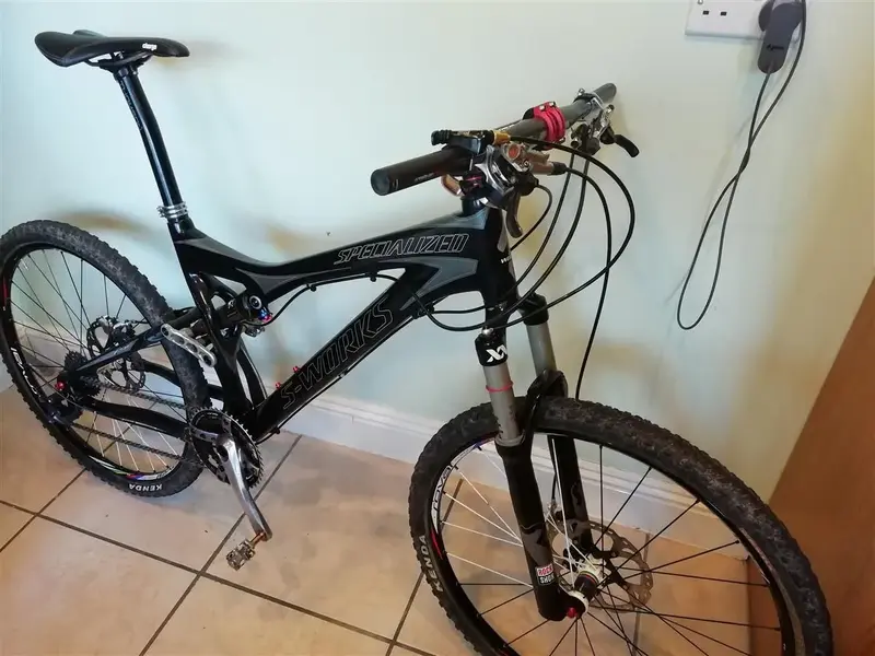

Fatal Swan
Fair point :D The photos I have of it as it was when I got hold of it weren't great so I'll do some mid-build in the next day or two!
Fatal Swan
Re: Sub-10kg/22lb S Works Full Sus - with a photo!

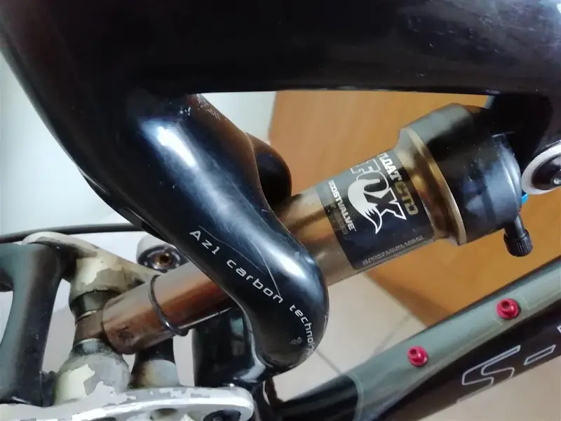

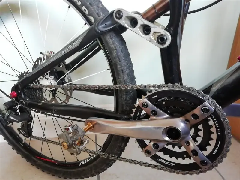

Bit of a delay assembling this one, but it's near enough there now. Time for a picture!
So it's coming out pretty much bang on 10.0kg with the following spec. I do need to swap out the Kenda Klimax Lite 345g tyres for something better suited to a full sus bike but otherwise I'm pretty close to complete. I've got a Thomson Masterpiece to go on which is about 60g lighter than the one fitted though it's silver and doesn't match well!
Spec as pictured is:
Specialized S works Carbon Stumpjumper FSR 25th Anniversary LtD Ed w/ Fox Float CTD Kashima.
RockShox Sid XX with remote.
Roval Controle e5 (1412g)
Kenda Klimax Lite 345g 1.95" folding
Schwalbe SV 14 A XX-Light 1.5-2.1" Inner Tubes
Shimano XTR M960 with TA C116 outer ring. 175mm
Shimano XT MT800 Hollowtech II BB
KMC X9-SL chain
Shimano Dura Ace CS-7700 12-27
BR-M988 XTR Trail brakes
Shimano RT-86 rotors 180mm
Shimano XTR SL-M970 Shifters
Shimano XTR M952 34.9 bottom pull FD (not yet fitted)
Shimano Dura Ace RD-7900-SS RD
Thomson Elite Setback 30.9 367mm
Charge Knife Ti saddle
Syntace F109 Stem 115g
Truvativ T40 Carbon Noir bar 580mm
Ritchey Truegrips WCS (not yet fitted)
Xpedo Mag Ti M- Force 4 clipless pedals, 229g
Titanium allen skewers, 32g
GUB 550 34.9 double seatclamp
Fatal Swan
A few not-so-great pictures up now, the bike should be properly assembled and set up soon then I'll take some with my camera and not my phone! Currently I've got a wobbly XTR brake lever which I'm not sure if I can fix, so that might slow me up...
