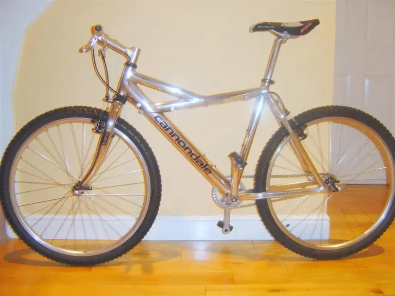

Finished and ready for dunkeld 8)

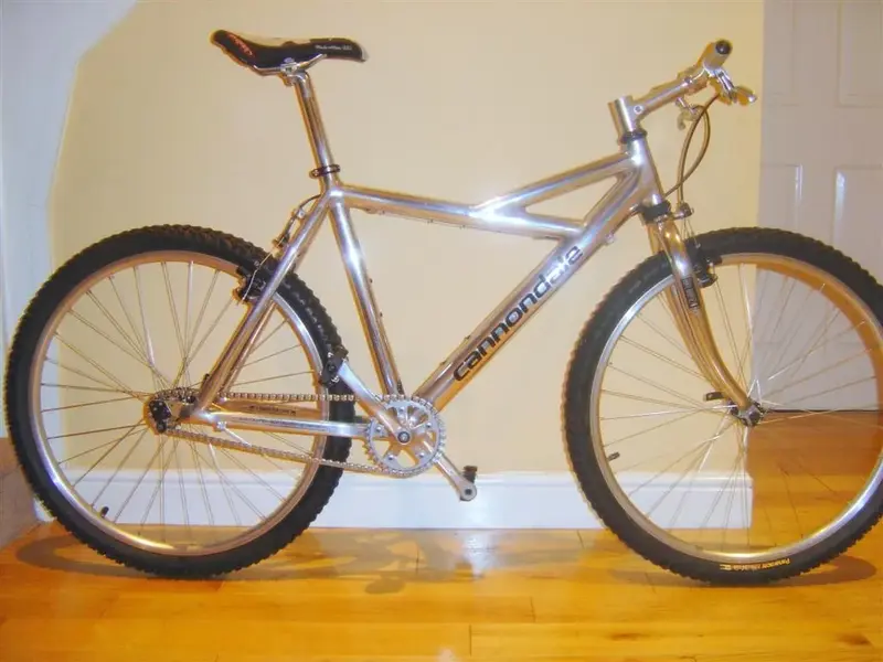

SOME MORE......

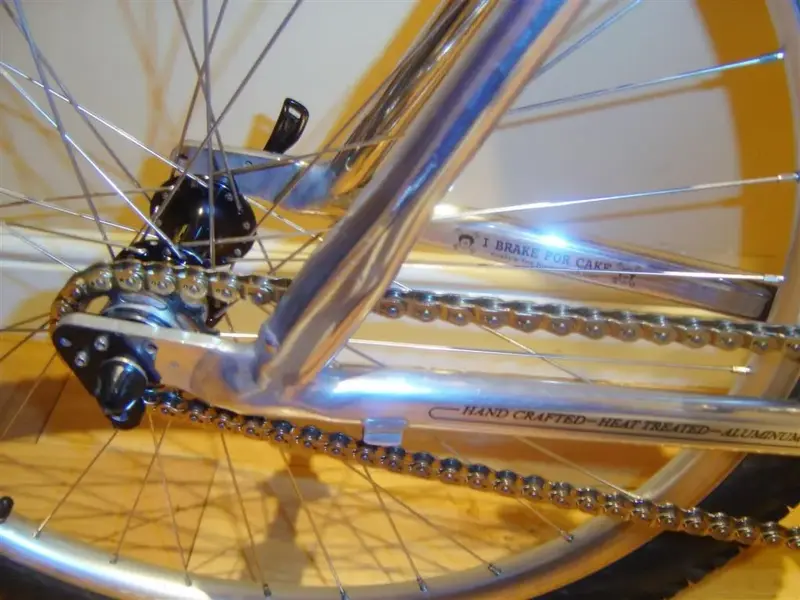

I'm begining to think its the rules that a polished alloy rigid dale SS conversion using only half links for perfect tension must be among the collective MacRetro bikes :D
Kaiser has one, then he sells it, then Clockworkgazz gets one !
I for one will not become part of this pattern........must.........resist......

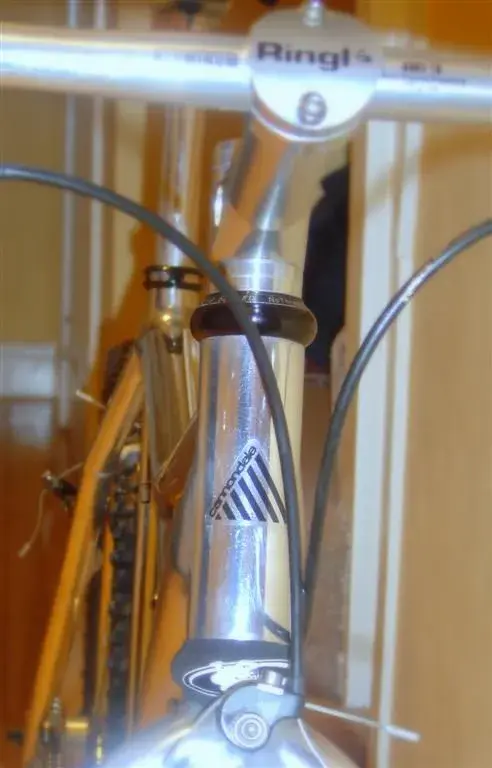

Splendid work chap :D I can see why your force 40 isn't working the best,to set up have the straddle wire from the canti to force 40 straight and the same for the wire from lever to canti.
you can give me a wee tutorial when we meet up- after about 2 hrs I have the brakes working pretty good so am not fettling until I'm sure I know what you mean :lol: Cheers 8)

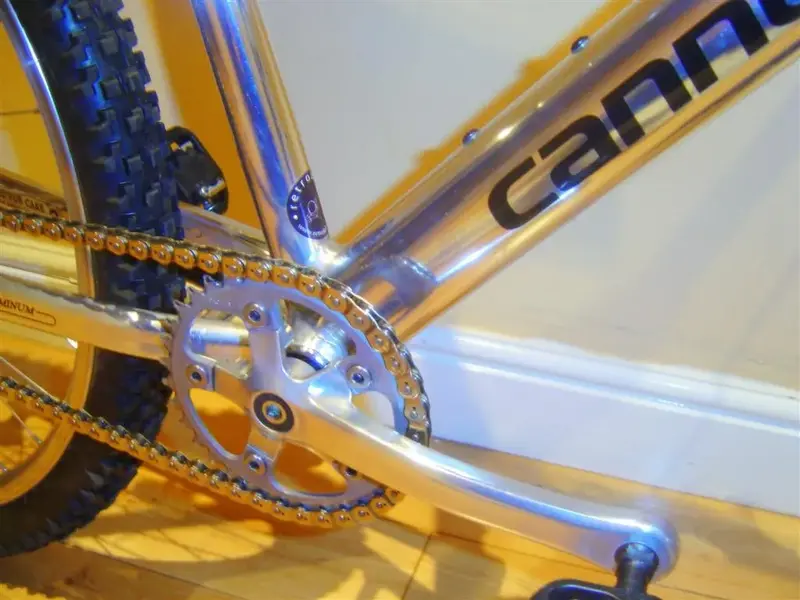

The polished look is great but it does require ongoing work unlike a paint job, as the al does oxidise and becomes dull.
I stripped the paint with nitromores and once it was the bare frame cleaned it first with brillo pads then scotchbrite pads and finally very fine wire wool to get the surface as smooth as poss.
Then I used brasso and lots of buffing- repeat until happy with the shine. Kind of zen like approach is needed esp. in the nooks and cranies. Kaiser (the master buffer) then used a special chemical that protects the al shine, I used a car wax but this will wash/wear away and a good buff will be needed periodically- well worth the effort IMHO.
Decals I got from dave h and another member whoes name escapes me :oops: to much wine- however I really need period correct ones o the retro bike member Gil_m will be called into action, he will sort you out there.
You have th makings of a great bike and even on the short ride I have been on I think a bit of front bounce will be very welcome- This frame is light and responsive but pretty unforgiving esp. as I am used to steel machines.
