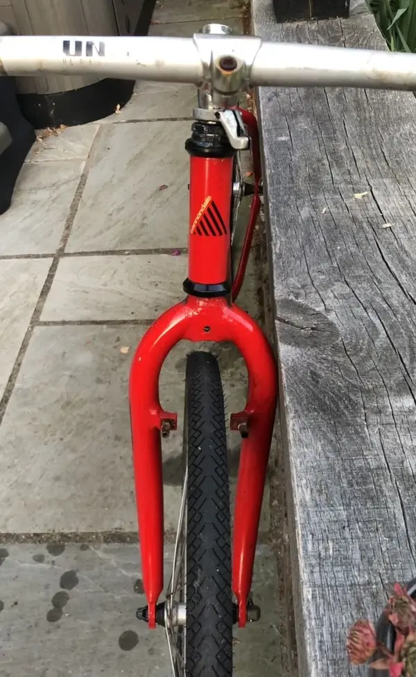

I’ve been offered a Cannondale at an as yet to be agreed price, but I know very little (i.e. nothing) about Cannondales, so don’t know what I should offer.
Only got a single picture of it at present and I’m struggling to identify which model it is.
From what I can see it’s red (duh), quill stem, Pepperoni forks, wish-bone seat stay, non-extended dropouts. Any ideas?? Thanks. A6B205C6-63A2-4A97-9003-0634F6BC01D7.jpeg

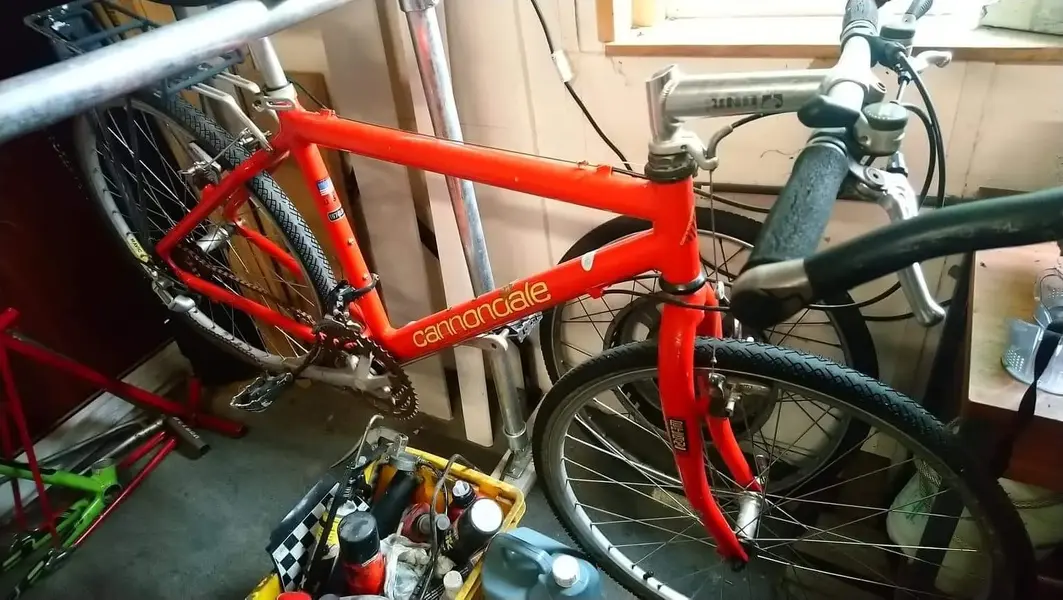

It might be the light or slightly out of focus photo but that looks like a fillet brazed frame to me. I don't know much about Cannondale but if it is fillet brazed then it's going to be worth a second look for sure. It looks a bit like this M300
Close - but I’m sure the one in my photo has a wishbone seatstay whereas the M300 doesn’t.

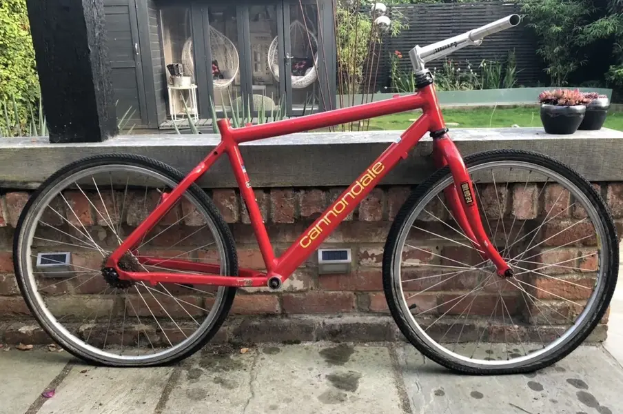

Collected it today and immediately tore it apart. Most of the parts are rotten, but somewhat surprisingly *most* of the parts came off.
Frame code ‘GD’ confirms it is an April 1995 bike, and without knowing how to decipher the rest of the frame numbers (I’ve read that they don’t actually give any clarity on model type), I’m of the opinion it is an M900. There’s a sticker which states it’s a 16”.
The only oddity is that the Pepperonis are threaded 🤷‍♂️

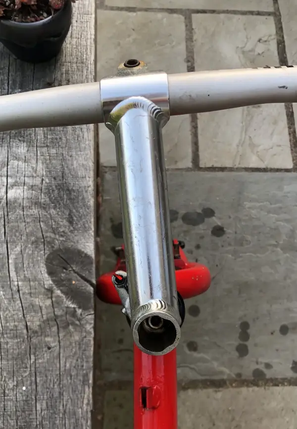

55015EBC-87D1-40BD-A2EB-BBB874EC0736.jpeg When I say most of the parts came off, the biggest issue is that the stem/headset/forks are stuck fast - I mean solid, I can’t even turn the bars with considerable force applied.
Cable guide undoes, headset does not, and I don’t have an Allen key that can access the stem bolt.
The skewers are spinning in their plastic end caps, and I’ve not managed to get the BB out yet.

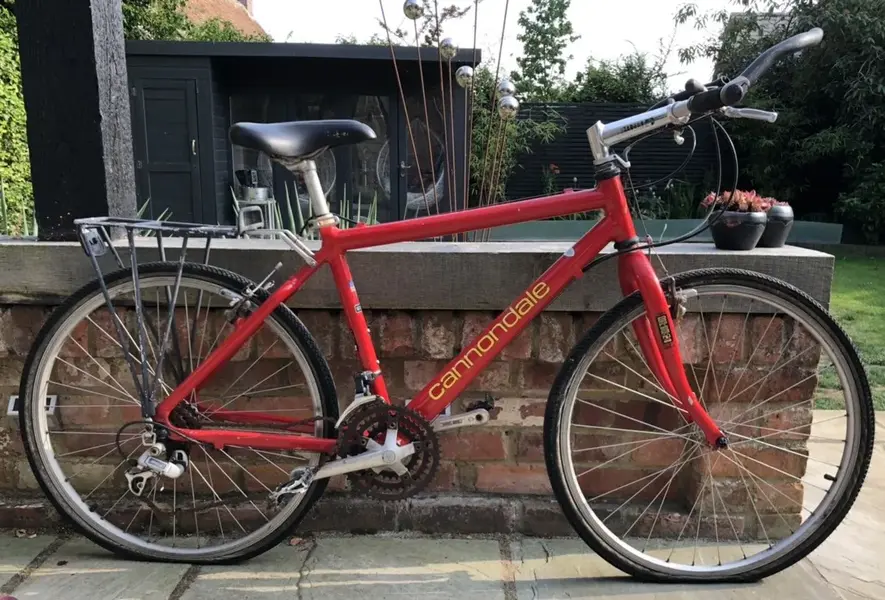

The rear triangle was full of fairly clear liquid, which was released when the wishbone rack mounts were removed.
Now to scratch my head as to how to release the front end….
