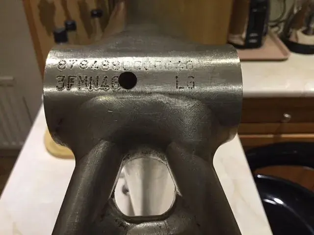

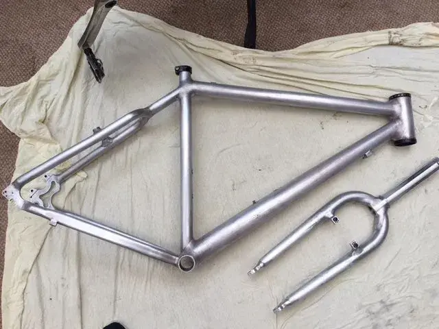

Hi all , I’m trying to I’d my frame so I can get some ideas on a colour scheme .
I’ve looked on the vintage cannondale site and if I’m correct then the LG is the month and year . L= 2000 & G= July .
http://vintagecannondale.com/info/serial_numbers/
But I’ve no idea what frame model this is ?
The forks have the lockout on top of the steerer tube and have the disc mount as well , so I’m presuming the forks are ultra fatty head shock, again not sure which model ?
There’s remnants of original paint inside the headstock which is red if that gives any clues.
Any help would be much appreciated .
Thanks scott

Looks like a Caad 4 frame to me. It has both disc and v brakes and were produced between 1999-2001. Caad5 was disc only but you also had the cheaper furio frames with both brake options. But I am not sure and that LG on the frame isn't probably the year indication because my 2005 optimo frame has it too.

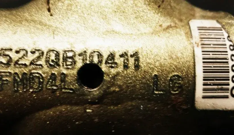

Yes it's a large too. Mine has a sticker to the right with a a letter on it followed by some digits. On the later models the letter indicates the year but your sticker is missing.
Try looking some other F series (has to be an F serie frame) and look closely at the rear disc brake mounts because there is where you will find the bigger difference I guess.

Ok , so just weighed it ,
Luckily my digital scales in grammes can just about handle it .
1548 grammes = 3.4 lbs .

Wow that is lighter then mine and bot are size L. I also used a digital kitchen scale so it should be ok. I am suprised and in shok too :)
Just noticed the cable guide on top and I stick to a F400 or F600 Caad3 frame when guessing.
