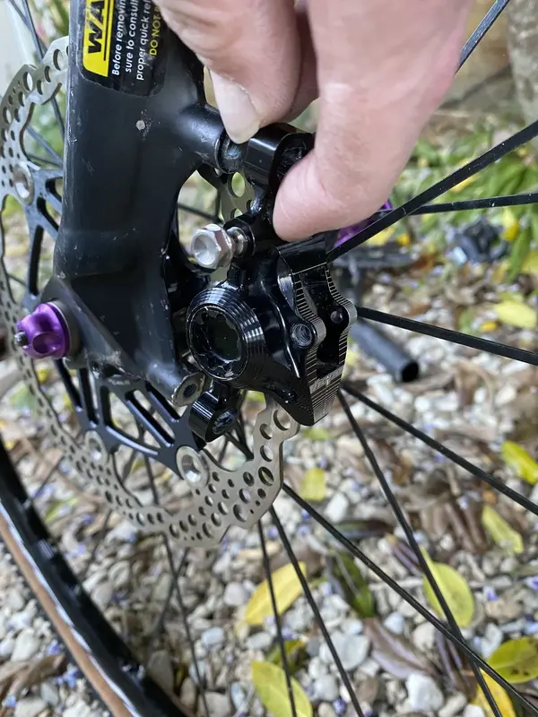

Tc Retrobike Rider Gold Trader Feedback View May 21, 2022 #1 I cannot see how to fit my hope x2 callipers to my bad boy frame! Anyone any ideas?

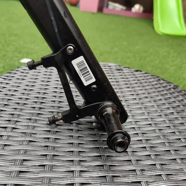

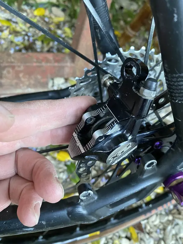

Tc Retrobike Rider Gold Trader Feedback View May 21, 2022 #4 The front I kind of understand but the rear holes face the wrong way & the calliper would have to be mounted upside down
davidj Senior Retro Guru May 21, 2022 #5 Rear needs an IS to post mount adapter, front needs a post to post adapter. You need adapters to match the size of your rotors. Front probably needs post to post 180mm adapter. Rear looks more like IS to post 160mm. The rotors will have their size stamped on them. Last edited: May 21, 2022
Tc Retrobike Rider Gold Trader Feedback View May 22, 2022 #6 Thanks mate that’s perfect & you were spot on with the sizes

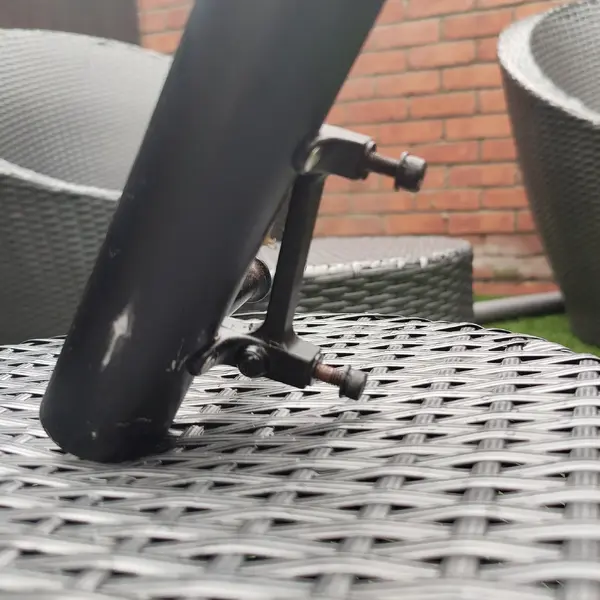

S Schmickles Dirt Disciple Sep 6, 2022 #10 @davidj The one I was looking at was 183mm but your flagging that helped me not buy the wrong thing! So, thank you @albash82 I've put photos of the mount on the fork. Does that help you make a definitive choice? Thank you Attachments IMG_20220906_142607.webp 220.9 KB · Views: 3 IMG_20220906_142553.webp 436.8 KB · Views: 3
