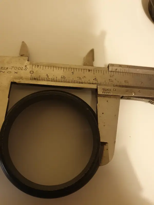

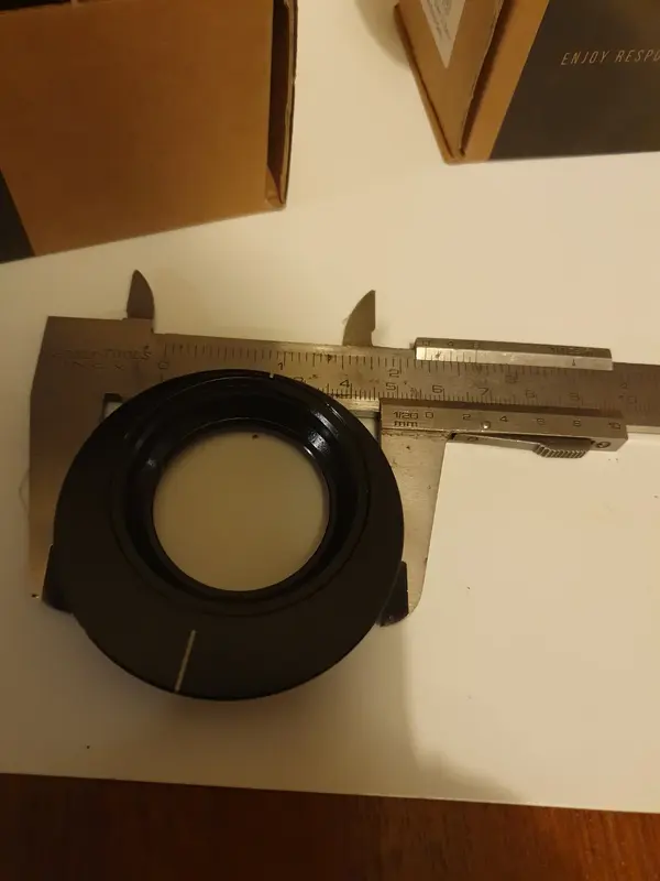

I ve got a cannondale with the oversize head tube that I assumed is 1.5 inch
I have the aheadset cups but no bearings the diameter of the cup that sits in the frame is approx 50mm
I bought a nukeproof 1.5 angleset cheap from crc but these cups are 56 mm
Something seems amiss is the cannondale not 1.5
See photos

The modern aheadset that I bought is bigger not smaller
Just been looking at head sets 1.5 inch equals 49mm
I measured the cannondale headset at 50mm so this seems correct
But the angleset headset is 56mm so what does it fit ?
Tried my local bike shop all their bearings are not the correct size
Two of the headsets in the cannondale link above look very similar but if don't fit would be an expensive mistake
Can some one explain modern headset codes
I think an ex 49 might work ( external cup with a diameter of 49mm ) I assume the part of the cup that sits in the frame is 49mm
