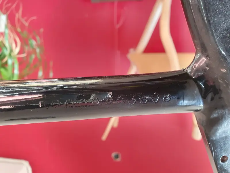

Trying to determine the serial on a Dale that I have.
Any tricks to make it readable other then X-ray vision?

Shining bright light at various angles might help -

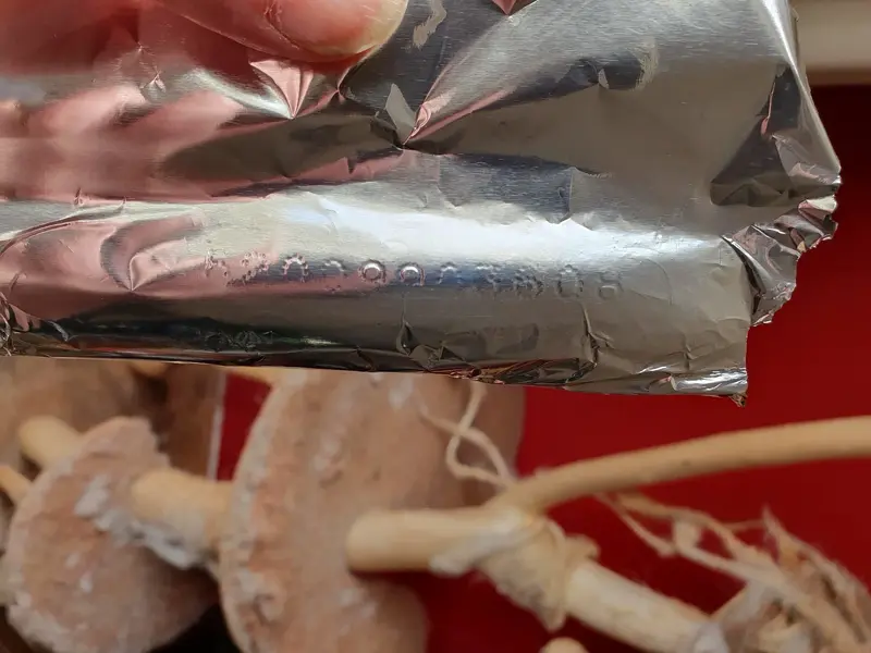

If you don't want to sand the paint back, you could put some kitchen foil over it and rub.
The paint is probably filling the indents though.
So I think this is the serial although it does not make a lot of sense.
The frame measures 56.5CM which is XL or 22"

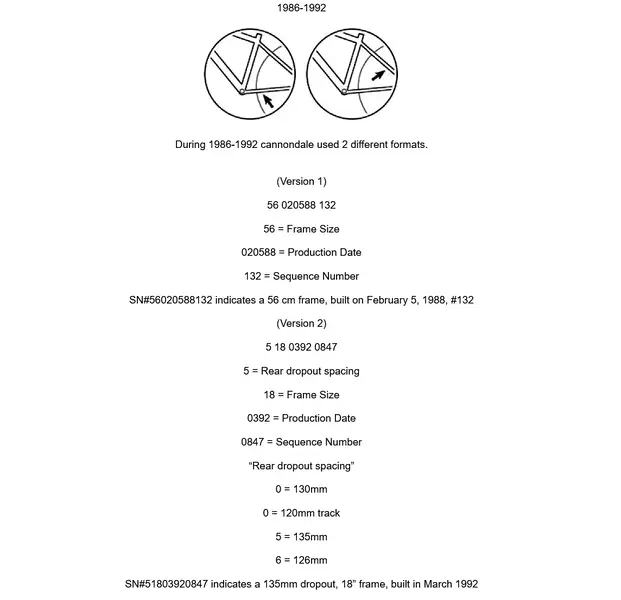

The serial is 52009903608 which would work out like this?
5 | 20 | 0990 | 3608
5: dropout 135mm
20: 20" frame
0990: built sept 1990
3606: sequence number (what?)

  • Screenshot 2024-08-21 at 10-45-17 Vintage Cannondale – Serial Numbers & Information VintageCa...webp

Sequence number is the production run, so yours is no 3606.
I don't know if this is just for frame size 20, or all sizes of the model - maybe an expert in these numbers will clarify, but it's far better info than 99% frame numbers give you!👍
C-C it's 50CM which would equate to 19.6" give or take a 20"
Didn't know Cannondale were measured like that ever but that must be it then.
