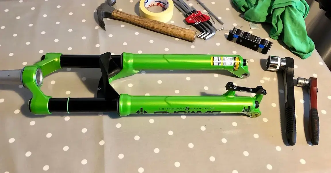

So the clamps to hold the air cartridge tightly in the vise arrived today, so it was time to strip the forks!
I bought a new 32mm six sided socket so as not to mark the top cap, and also ordered some 'Park AV-5 Vise Inserts' (clamps) to hold awkward things like fork air cartridges in place so they can be worked on!

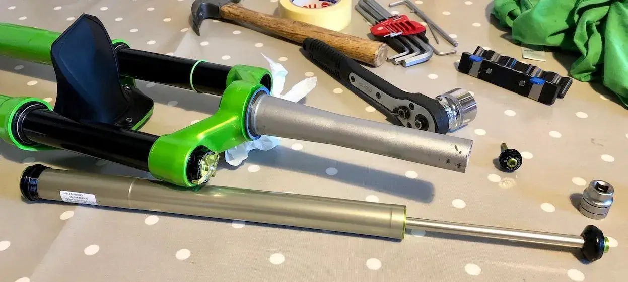

32 mm socket for top cap removal, followed by an 18mm for the dial at the bottom of the leg and the cartridge was out....

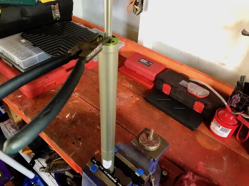

Clamps were to hold the cartridge still so I could remove this cap which apparently is VERY tight!

My friend has a garage with a vise, so I borrowed his keys and set to work...
I had to tighten the vise more than I felt comfortable doing, but there was no way to remove the cap otherwise, so I cranked it up!

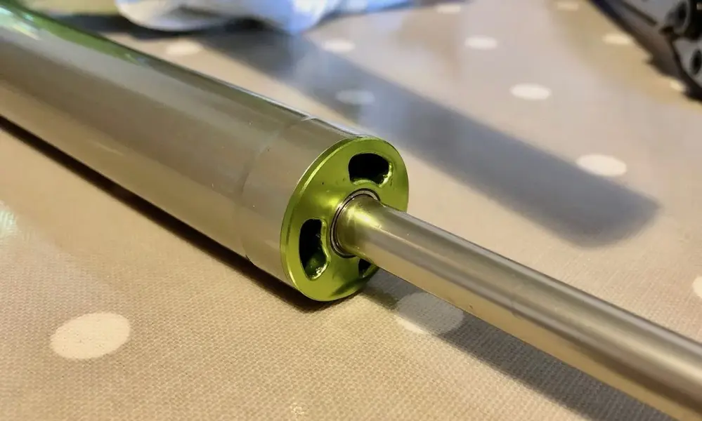

It came out without a fight fortunately, and I removed the negative spring assembly, pulled the springs from their seat and popped the 10mm spacer on....

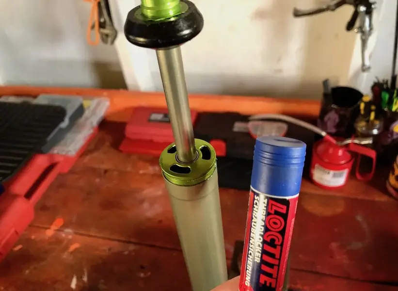

Re-seated the spring and slid the assembly back into the cartridge with some loctite reapplied to the cap, it was then refit, tighten and job done!
