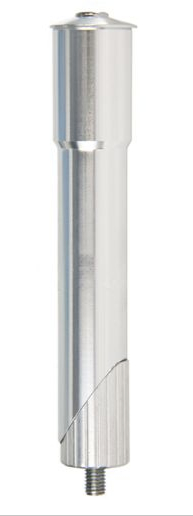

You can get threaded to aheadstem adapters which would be a good solution (quill part bolts into the threaded forks and the top of the adapter is smooth to allow fitment of an aheadstem). You need to use an a headset though.
What do the adapters do? I was thinking the only issue would be clamping of the stem onto the threaded part of the steerer? I take it I'm wrong there then?
This kind of thing, I have used them a couple of times. You can get them in various sizes, not essential though.
