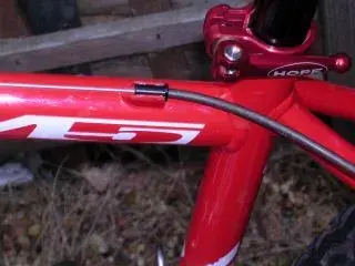

Specialized make them. I had a set basically an insert that fits inside the existing (larger diameter) guide, with a stop at the end for the cable outer to butt up against, and a flange at the other end to stop it just pulling through the guide.
I picked a set up about 3 years ago through Condor to convert back from a magura Hydrostop to a canti.
These are the Specialized ones. Quite happily running XTR V's on my frame with them, think they were a fiver or so for a pair direct from Specialized
