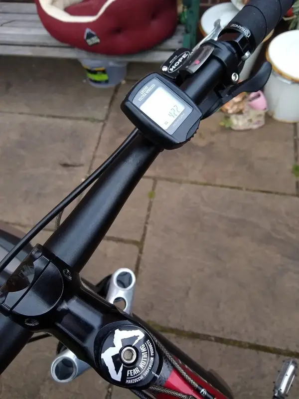

The steerer tube had been previously cut at a quite severe angle, a bit of effort with a file leveled it up with care to prevent any filings damaging the stanchions or fouling bearings.
I was then able to fit a SFN and my Marzocchi top cap, I have had it for a few years but never a situation where I could use it. The Hope Head Doctor was doing a fine job but I wanted to use this one. Head Doctor is in the for sale section if anyone is interested.

Enjoying the write up. I have always admired the look of these frames as they have a certain skinny elegance. Nice to hear about the odd component getting used that has likely been in the toolbox for years. Use what you have is my motto
When I saw the Thomson stem and bar going on I thought it was becoming more than just a pub bike! Enjoyable write up and good to see the Merlin getting a new lease of life.
I just bought back my old 96 Merlin frame as it was such a fun ride and slowly starting to rebuild. Picked up a bargain Marzocchi z2 xfly as no other retro fork comes close. Any other future plans?
