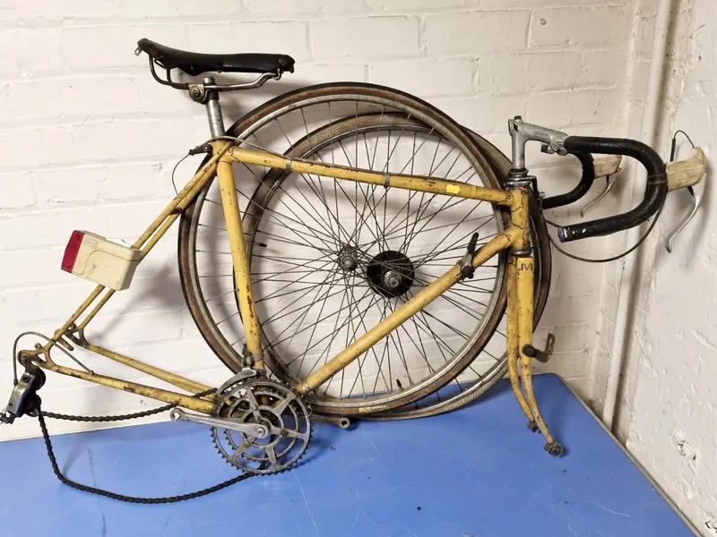

can anyone identify this bike?
vickej
Just bought from a local auction - this is the only image I have at the moment as I haven't collected it yet! I bought it as a project to restore to keep me busy during the dark evenings! I don't think it's anythig particularly special but it looked interesting enough to leave a bid. I thought perhaps Falcon or similar.
Any help greatly appreciated!!:) mystery bike.webp
Looking at the seat cluster wrapover I would say it possibly came out of the Raleigh/Carlton/BSA/Sun stable. Or maybe Falcon?
dropouts appear either Cyclo of England or Agrati
Cyclo dropouts would be consistent with a Falcon/Coventry Eagle product
pulleys on the Allvit rear mech appear to be all metal, last year for this was 1965
presence of GB brake levers and centrepull hangers suggests original brake calipers may have been GB model Coureur 66 which launched in '62. this, when combined with all metal derailleur pulleys would bracket machine's birth annum to the '62-'65 window
chainset Williams or Nicklin replica thereof
did it come with pedals?
if it were a Carlton product shell will be underwidth, about 66.5mm
serial placement and format may be of assistance

It arrives next week so I'll have a good look and figure it out!
