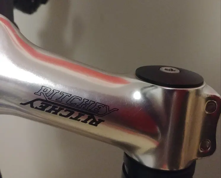

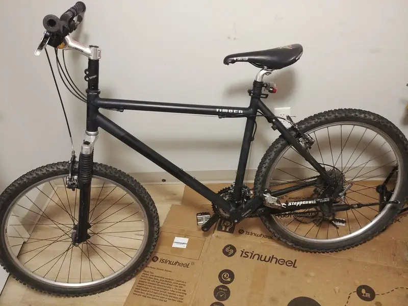

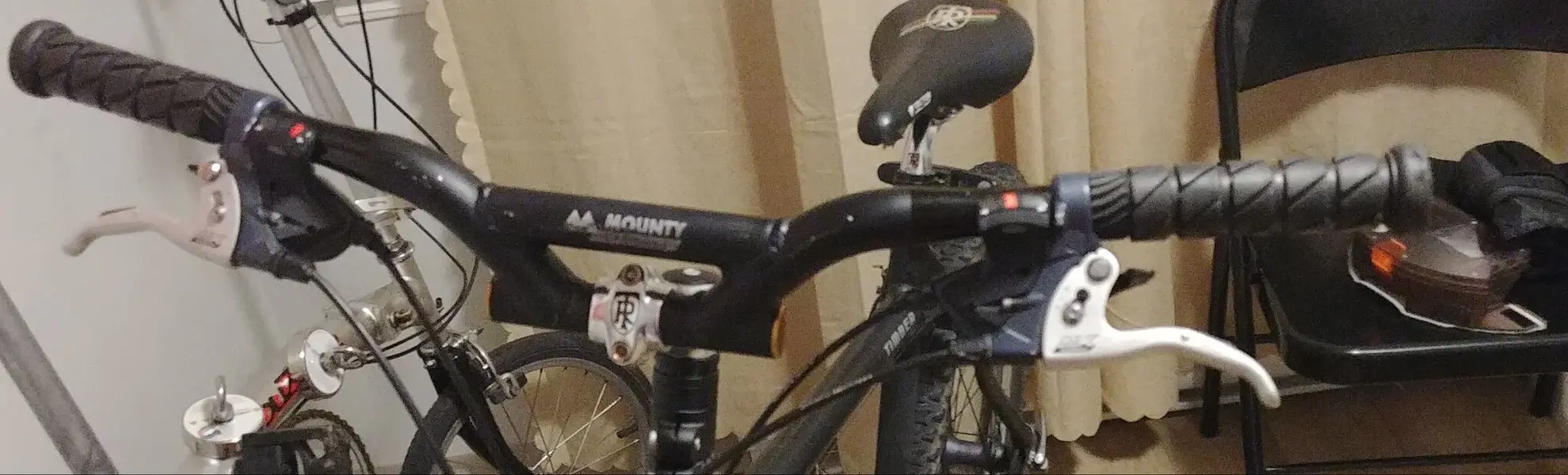

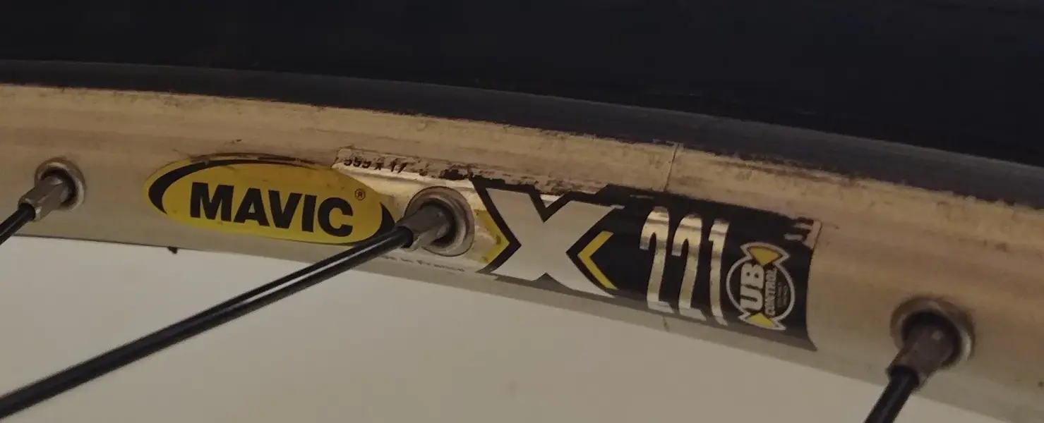

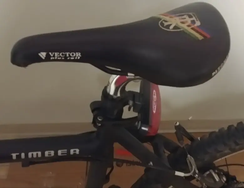

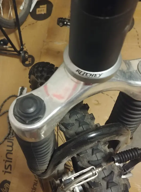

can anyone help me identify the make of this bike.
burke6588
I paid $50 for this and was wondering if anyone could tell me if it is an actual Ritchey bike or a bike with Ritchey components. I an just looking to find any info at all. Thankyou in advance!!

Well its certainly fitted with ritchey components, but sadly it's a fairly basic aluminium alloy frame. Most likely mass produced. The dropped toptube is fairly distinct, khs did that, the Alite, and a good few others.
For £50 it's a good build kit for a nice late 90s steel frame👍
all needed information is on your picture ...
It's a Steppenwolf (like on the frame protection, just typically this should been mounted on the chain side :rolleyes:), a German brand.
The model is Timber (the decals is still there).
Like this one
https://bikejan.com/17135/steppenwolf-timber/steppenwolf-timber-01-web/
Just an basic bike, not very interesting to collectors or real bike fans, so i do agree to the value estimate above.
