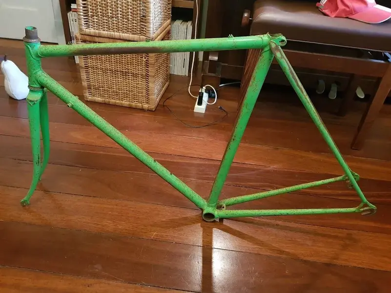

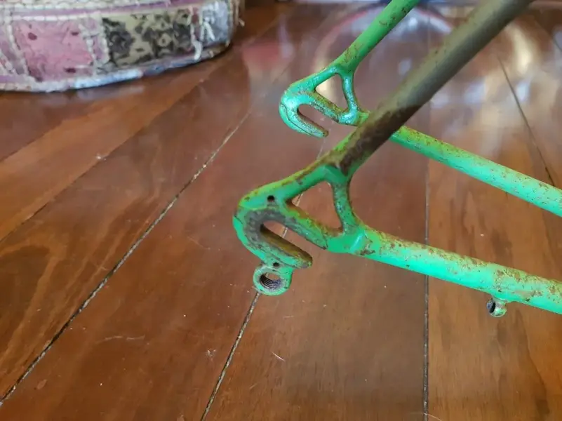

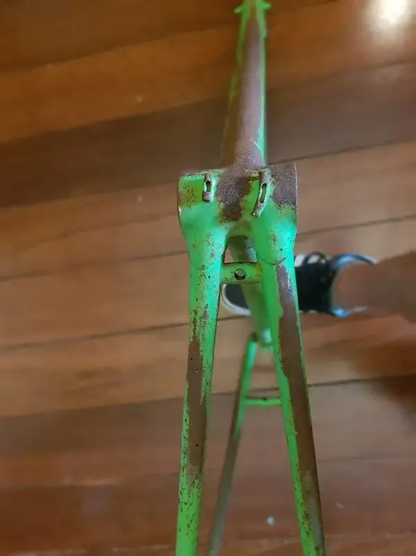

Hi,
I bought this frame without looking carefully (luckily for $ next to nothing) a few years ago and its been hanging in the shed since. I am just now deciding whether to fettle and build it or leave it be, wondering if the tiny rust holes on the underside of one chain stay mean it's unusable/unsalvageable, I thought so
It's a very light frame at 1580g, the forks are 640g
no rifling in tubes
126mm rear spacing, 27.0 seatpost, 65mm BB shell, italian thread
campag dropouts, rear with porta catena drillings
rear brake cable brazings along top of top tube
No idea the precise age but I assume late 70's or newer because of the porta catena and not later than late 80's because of the rear wheel spacing
Any thoughts/advice welcomed and appreciated
