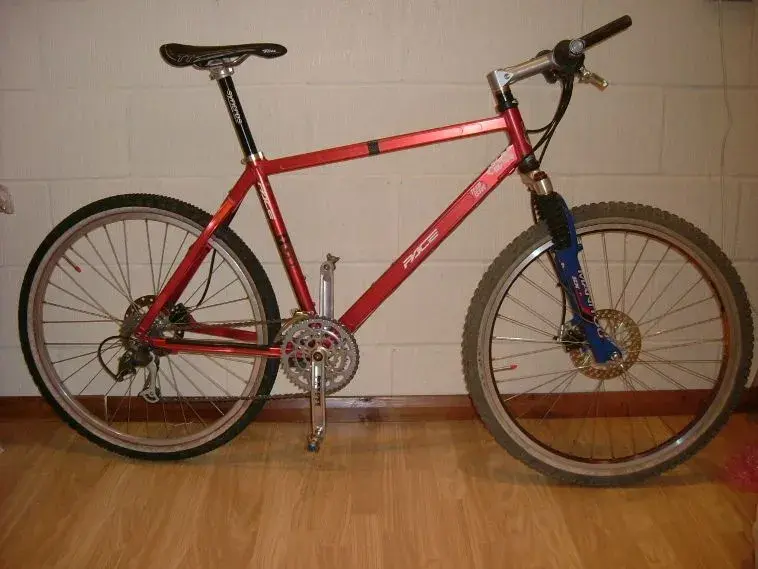

Original Pace frames were anodised exclusively AFAIK...anodising is where the frame is dipped in acid and the frame having an electrical current passed through it and then dyed.......paint is just paint.
If yours is red ano then its probably a Team Issue..... :)
This is a Team Issue >>>>
