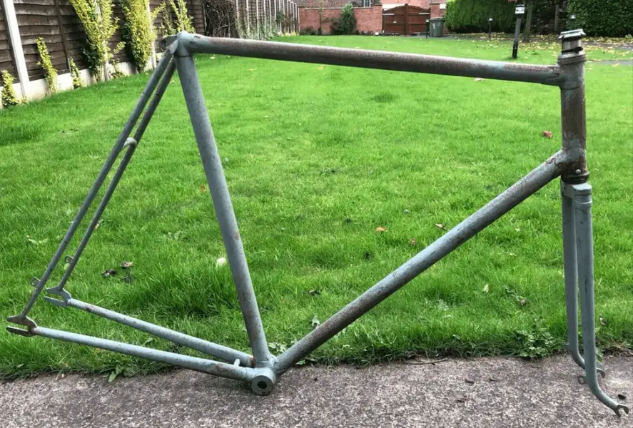

here is a shoot of the whole frame.

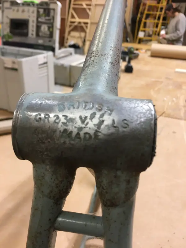

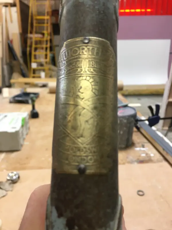

Hi, a serial number would be good, generally they are on the underside of the bottom bracket, pre war Holdsworths can have it on the seat lug but it should be on the steerer at least. Nice Frame. Thanks Terry
Thanks Terry I’ll have look. I know the bottom bracket has Chater Lea markings.

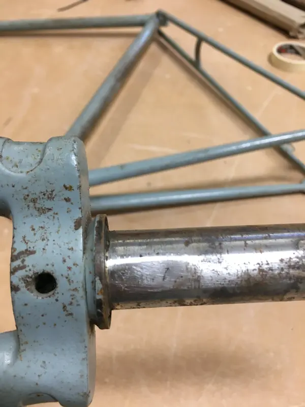

Hi, that bottom bracket ( not Chater Lea ) and another look at the geometry would point me to post war, maybe an outside chance of very late thirties, I would check that steerer it will be your only way of confirming what the serial number is. Thanks Terry
What is a 'coslettised' finish? Some form of metallic given the 'Bronzee' colour offered? And 'Zone' silk tyres? Tubulars I presume. All very interesting. The position in the catalogue image looks extremely 'fierce!
Ive had another look at the frame dropouts, Seat Lug and Bottom Bracket and so far havent found any numbers.
I have only found asingle number 7 on the fork sterier.
nothing on the fork crown.
Dose any one have any other tips?
Or dose any one have any photos or mesuerments i could compare with?
